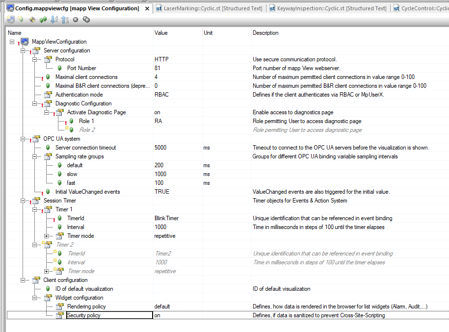

Am I blind or is there no watchdog setting on my MappView configuration.
 ![](https://europe1.discourse-cdn.com/brcommunity/original/2X/9/938d1b391d94dead5b08b34332cdce191115c95c.png)
**Author:** ![phaehnel](https://avatars.discourse-cdn.com/v4/letter/p/FF8800/32.png) [@phaehnel](https://community.br-automation.com/u/phaehnel)\
**Post date:** [August 1, 2025, 1:24pm UTC](https://community.br-automation.com/t/6ppt50-resetting/7762/6 "2025-08-01T13:24:36Z")
The watchdog is unqiue to every visulization, not to the mappView server part.
You would have to add this into the \*.vis file in the configuration xml node.
See help entry here:
> **[B&R Online Help](https://help.br-automation.com/#/en/6/visualization/mappview/engineering/organization/visualization/configurations.html)**
