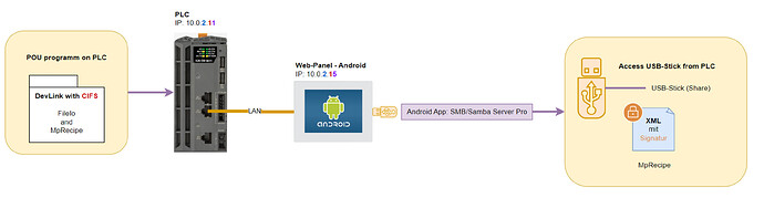

Hi team,
I want to access a USB-Stck plugged on the android panel (with mappVIEW-visualisation, side topic) from my PLC. The PLC shall export diagnosis- / statistic files like XML, CSV, PDF to the USB-Stick.
**A - SItuation**
- IP 15: Android Panel with mappVIEW-Visualisation + USB-Port
- IP 11: B&R PLC with data to be exported to USB-Stick which is plugged on Android-Panel
 ![image](https://europe1.discourse-cdn.com/brcommunity/original/2X/0/05a4fcdb8717f88446a5919b47c8fea4f538333f.jpeg)

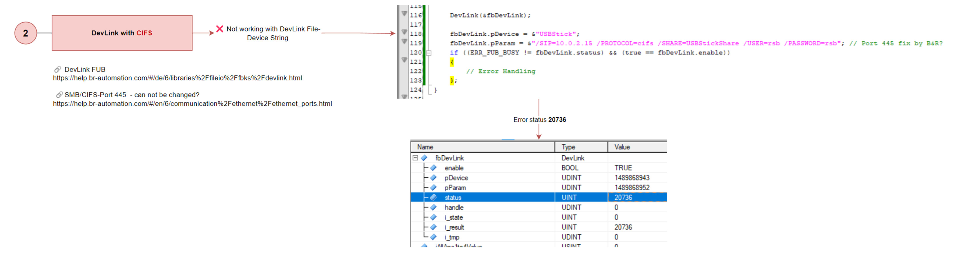

**B - Several ideas, several fails**
❌ B1: CIFS, port 445 = I couldn’t get access with FileIo and FUB DevLink: Error 20736
❌ B2: FTP, port 21 = I couldn’t get access with FileIo and FUB DevLink: Error 20736
 ![image](https://europe1.discourse-cdn.com/brcommunity/original/2X/4/49dbb70f8e501918d8e41a4abfe4f921619df70c.jpeg)
🔗 DevLink FUB [B&R Online Help](https://help.br-automation.com/#/de/6/libraries%2Ffileio%2Ffbks%2Fdevlink.html)
🔗SMB/CIFS-Port 445 - can not be changed? [B&R Online Help](https://help.br-automation.com/#/en/6/communication%2Fethernet%2Fethernet_ports.html)
💡 My guess:
CIFS access by B&R FileIo runs directly “static” from port 445. However, port 445 is not possible on the Android panel (…as far as I know), because otherwise I would have to root the panel. Which I can’t do, and don’t want to do (warranty, etc.).

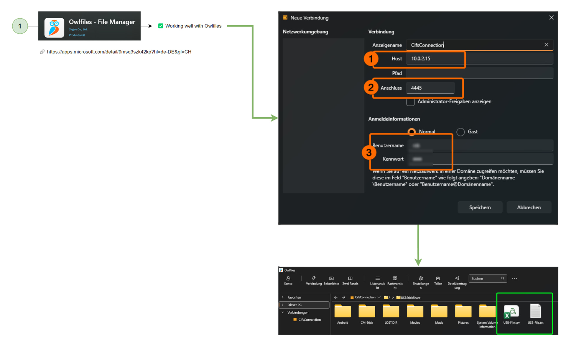

✅ B3: Subsequently (exclusion, cross-check, proof), I did the same with a Windows SMB client, where I can set the port:
 ![image](https://europe1.discourse-cdn.com/brcommunity/original/2X/8/85f3bbc6ea1eaad5e70682dd23f0f7a1f0ed086e.jpeg)
The files marked in green are two test files on the B&R USB stick, which is plugged into the Android panel.
🔗 [Owlfiles - File Manager – Kostenloser Download und Installation unter Windows | Microsoft Store](https://apps.microsoft.com/detail/9msq3szk42kp?hl=de-DE&gl=CH)
Since I can access the USB stick here without any problems, I am now looking for a way to do the same with the B&R PLC (X20EM0611, X90). Any idea / experience?

Hello Samuel
I do not see a possibility to change the port via AR / Devlink.
So if you cannot use Port 445 from Android side, only way I see is to think about alternative for a file transfer.
You could think about providing the file via web and access / transfer it via AsHttp, or AsTcp or OPC UA.
But interesting question, maybe we get some more inputs from community.
