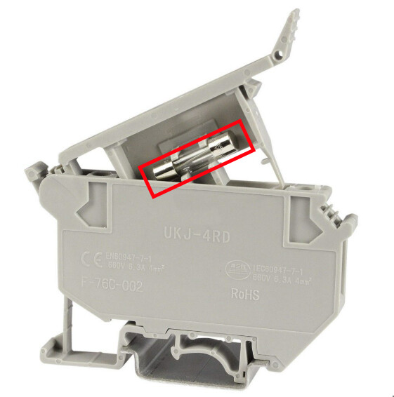

Hi @alvin.lim , I have seen an issue before where a 6D power supply box was not providing power due to a terminal block having a fuse that was blown. If you have one of these terminal blocks in your power supply box, I would recommend taking it out and checking the fuse, and if it looks blown, replace the fuse or the whole terminal block.
If this is your issue, it could have been caused by a short in your power cable. I would recommend checking the continuity of the individual wires in the cable with a multimeter.
