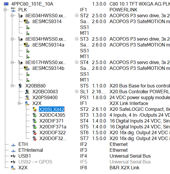

I have three Acopos P3 SafeMotion, two 8EI034HWSS0.0200-1 and one 8EI017HSS0.0600-1, and two works fine, but one (8EI034HWSS0.0200-1) has some problem, the LED SE is constantly on. I installed the latest version of the SafeMotion hardware module and AcoposP3, but it did not help.
It has been doing this since the first power up.
I am using AS (4.12), Safedesigner (4.4.1), ACP10/ARNC0 5.29.1, mappSafety 5.24.1, AR P4.93, the main controller is 4PPC80.101E-10A.
From logger:
 ![logger](https://europe1.discourse-cdn.com/brcommunity/original/2X/e/e9ebc110e7beb3e3fe3b0f310791d23b7cd53d07.png)
Hardware config:
 ![hardwareConfig](https://europe1.discourse-cdn.com/brcommunity/original/2X/c/c079d1694e2c722d0fc47c01ebb3cd11753e4050.png)

On one Acopos P3 (8EI034HWSS0.0200-1) the LED SE is constantly on. It has been doing this since the first power up. I am using AS (4.12), Safedesigner (4.4.1), ACP10/ARNC0 5.29.1, mappSafety 5.24.1, AR P4.93, the main controller is 4PPC80.101E-10A.
I have three Acopos P3 SafeMotion, two 8EI034HWSS0.0200-1 and one 8EI017HSS0.0600-1, and two work fine, but one (8EI034HWSS0.0200-1) has some problem, the LED SE is constantly on. I installed the latest version of the SafeMotion hardware module and AcoposP3, but it did not help.
From logger:
Does anyone have any suggestions on what I should try and how to solve the problem?
BR,
Mihajlo
this is my Hardware config.

If you changed the drives and the error went along WITH the drive, the drive itself has a fault. Unfortunately it’s not very clear from your phrasing.
**Author:** ![Mihajlo\_Tatovic](https://avatars.discourse-cdn.com/v4/letter/m/FF8800/32.png) [@Mihajlo\_Tatovic](https://community.br-automation.com/u/Mihajlo_Tatovic)\
**Post date:** [September 30, 2025, 4:32pm UTC](https://community.br-automation.com/t/acopos-p3-safemotion-problem-se-led-constantly-on/8522/9 "2025-09-30T16:32:15Z")
I have two same Acopos P3 SafeMotion (one works and one fail), to check the wiring/cable I did the following:
I switched each cable from the working driver to the faulty one, and from fault driver to wrking driver.
The situation is the same, the faulty driver still gives the same error.
This means that the problem is not with the cabling and the rest of the hardware. The problem is with the ACOPOS P3.
**Author:** ![michael\_w](https://avatars.discourse-cdn.com/v4/letter/m/FF8800/32.png) [@michael\_w](https://community.br-automation.com/u/michael_w)\
**Post date:** [October 1, 2025, 10:54am UTC](https://community.br-automation.com/t/acopos-p3-safemotion-problem-se-led-constantly-on/8522/10 "2025-10-01T10:54:48Z")
And Roman’s suggetion was to switch the drives and see if the issue stays on the same drive.
But it looks like, just as said, that the drive is at fault. Contact your local B&R office and get it exchanged I guess
