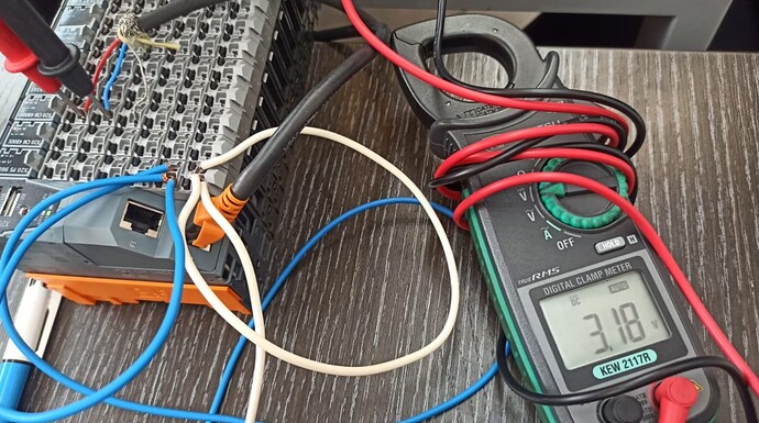

Hello guys,
I would like to ask you for clarification regarding the connection between my accelerometer and the X20CM4800X module.
The accelerometer cable I am currently using has only two wires:
- **Red wire** : connected to IEPE+ / signal
- **Blue wire** : connected to 0V
- Additionally, there is a **grey shielding wire** that I connected to close the circuit.
However, according to the X20CM4800X datasheet, the module expects a 3-wire connection: IEPE+, IEPE−, and shield.
 ![image](https://europe1.discourse-cdn.com/brcommunity/original/2X/c/ccfc32a76dfee98c16fbfb433a0b4644564ae99e.jpeg)
The issue is that the module indicates a broken wire.
I would like to know if it is possible to connect my accelerometer to the X20CM4800X module, and if so, how should I proceed to do it properly?
 ![image](https://europe1.discourse-cdn.com/brcommunity/original/2X/4/434b57857e7ab4b352995b423d1a786e500d322b.png)
 ![image](https://europe1.discourse-cdn.com/brcommunity/original/2X/2/2c06e2278dd8be79768a5c5688e86f8bb95d6ac2.png)
 ![image](https://europe1.discourse-cdn.com/brcommunity/original/2X/d/df786ba42b9a4bd962c4b05101b6862178ae3d15.jpeg)

**Author:** ![Yacine](https://avatars.discourse-cdn.com/v4/letter/y/FF8800/32.png) [@Yacine](https://community.br-automation.com/u/Yacine)\
**Post date:** [June 6, 2025, 9:15am UTC](https://community.br-automation.com/t/circuit-of-the-accelerometer-and-the-module-x20cm4800x/7222/8 "2025-06-06T09:15:34Z")
i mesured the voltatge between IEPE +/- and i found it equal 3.18 V and this is less than 8 v rocommanded by B&R and for the sensor it works between 8 and 12V. i don’t know why the module give me this voltatge and how i could resolve this problem.
 ![image](https://europe1.discourse-cdn.com/brcommunity/original/2X/f/f61b9176b90af51e35bd7d5dbd776e76d2967b07.jpeg)
**Author:** ![christoph.hilchenbac](https://dub1.discourse-cdn.com/brcommunity/user_avatar/community.br-automation.com/christoph.hilchenbac/32/423_2.png) [@christoph.hilchenbac](https://community.br-automation.com/u/christoph.hilchenbac)\
**Post date:** [June 6, 2025, 9:47am UTC](https://community.br-automation.com/t/circuit-of-the-accelerometer-and-the-module-x20cm4800x/7222/9 "2025-06-06T09:47:15Z")
I would guess your sensor requires more current than the maximum of 5.5 mA ☹. You could contact the manufacturer to be sure.
