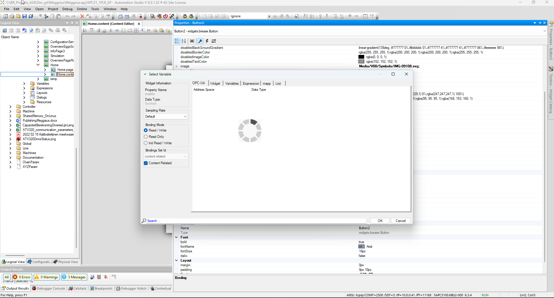

We have an problem that we can not make an binding in the design time on a page.
This is in AS6.3.1. Does anybody know what can cause this problem?
We already know an workaround only that is not workable.

**Post date:** [July 29, 2025, 11:57am UTC](https://community.br-automation.com/t/create-binding-in-design-time-not-working-in-as6-3-1/7800/2 "2025-07-29T11:57:24Z")
I think this is know issue related to OPCUA C/S version used, what version do you have?

Hi Jaroslav,
I have this version:
 ![image](https://europe1.discourse-cdn.com/brcommunity/original/2X/9/9018ed72d8366c8d404e1529d6370c9173f8e974.png)
I have tried version
6.0.0 and that works.
**Post date:** [July 29, 2025, 12:06pm UTC](https://community.br-automation.com/t/create-binding-in-design-time-not-working-in-as6-3-1/7800/4 "2025-07-29T12:06:04Z")
ok then it is known problem. AS 6.3.2 will provide a fix.

Unfortunately, I’m also having problems with the new OPC UA version 6.3.x, including the one you described. I’ve gone back to OPC UA 6.0.

Automation Studio 6.3.2 is now released and available on the website.
