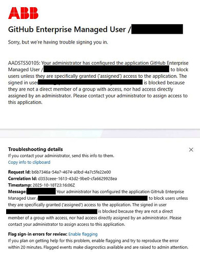

Problem 2 - If I go to Github and try to download there - [GitHub - br-automation-community/mapp-Framework](https://github.com/br-automation-community/mapp-Framework?tab=readme-ov-file) - i am directed to an ABB\_EMU login. When I put in my credentials it displays a message saying access has been blocked as I am not a member of a group with access:
 ![image](https://europe1.discourse-cdn.com/brcommunity/original/2X/8/865e2971a11841531b2b406cd1695eb8e430c488.jpeg)
What to do from here? i just want to get started with MappView but did not foresee these issues….

Hello and welcome to the Community,
I can access the link you’ve provided and since it’s public repository it’s really strange it doesn’t work for you.

Thanks for your reply, as mentioned I am unable to download the technology package to try the sample project. That was my question, how can I access the package with the blocks i mentioned… When you try to download does it take you to ABB log in?
**Author:** ![pavel.vavra](https://dub1.discourse-cdn.com/brcommunity/user_avatar/community.br-automation.com/pavel.vavra/32/9893_2.png) [@pavel.vavra](https://community.br-automation.com/u/pavel.vavra)\
**Post date:** [October 22, 2025, 5:35am UTC](https://community.br-automation.com/t/download-and-instll-mapp-view-technology-package/8733/4 "2025-10-22T05:35:20Z")
Sorry, I didn’t get it. In general, you install all upgrades (technology packages included) via Tools-Upgrades in Automation Studio, see [help](https://help.br-automation.com/#/en/6/projectmanagement/upgrades/updates_online.html). If you can’t download upgrades via Automation Studio (a reason could be you have an Automation Studio resell license), you can download them on the B&R website **without login** - [mapp View 5.24.7](https://www.br-automation.com/cs/ke-stazeni/software/automation-studio/tp-upgrades/v43-tp-upgrade-mappview-5247121/) for example - and install them locally.
