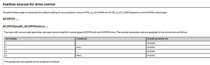

Hello everyone,
I have the following problem, which I have not yet been able to solve with existing posts from the forum.
I am using an AcoposMulti (single) on which a real axis runs. Now I would like to create an additional virtual axis that receives an encoder value from an external encoder. The encoder is connected to plug-in module 2 (SS2) of the Acopos. (8BAC0123.000-1) Unfortunately, I am unable to obtain a position value. I have already tried different ParIDs, but without success.
Best regards, Michael 🙂
**Author:** ![christoph.hilchenbac](https://dub1.discourse-cdn.com/brcommunity/user_avatar/community.br-automation.com/christoph.hilchenbac/32/423_2.png) [@christoph.hilchenbac](https://community.br-automation.com/u/christoph.hilchenbac)\
**Post date:** [October 24, 2025, 8:22am UTC](https://community.br-automation.com/t/external-encoder-on-slot-2-for-virtual-axis/8782/2 "2025-10-24T08:22:42Z")
according to [Position sources for drive control](https://help.br-automation.com/#/en/4/ncsoftware/acp10_drivefunctions/antriebsregelung/geberverschaltung/positionsquellen_fur_die_antriebsregelung.html)
 ![image](https://europe1.discourse-cdn.com/brcommunity/original/2X/b/b107348c9188cbc273f8b474662e67266db7e75d.png)
you can get the position from [ENCOD1\_S\_ACT (91)](https://help.br-automation.com/#/en/4/ncsoftware/acp10_parameter/html/encod1_s_act.htm) from 2nd axis (even if you use a single axis module)
