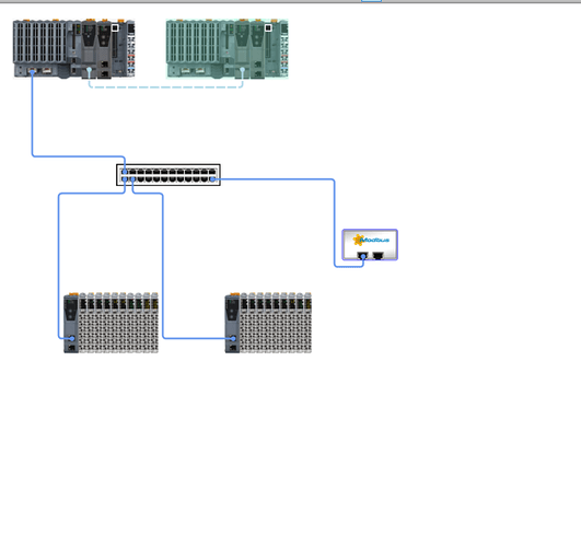

Hi everyone,
I’m new to B&R and currently setting up a redundant system using **X20CP3684** controllers. I’m facing two issues:
1. **Modbus\_TCP\_Any:** It only works on either the primary or the secondary controller — never both at the same time. When one is OK, the other reports an error.
2. **OPC UA Server:** I want to provide data points to another monitoring system (Tridium Niagara) using the **cluster IP** , but it only works when I enter the **primary IP**. It doesn’t seem to respond through the cluster IP.
Could this be due to a configuration issue, or is there something I’m missing in the redundancy setup?
Any guidance or examples would be greatly appreciated.
Thank you for your help!

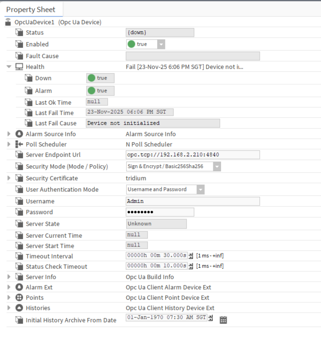

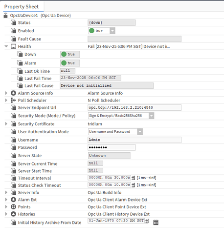

**Author:** ![Win\_Lai\_Aung](https://avatars.discourse-cdn.com/v4/letter/w/FF8800/32.png) [@Win\_Lai\_Aung](https://community.br-automation.com/u/Win_Lai_Aung)\
**Post date:** [November 23, 2025, 10:05am UTC](https://community.br-automation.com/t/help-with-b-r-redundant-system-x20cp3684-modbus-tcp-any-and-opc-ua-cluster-ip-issues-as-version-6-1-1-14/8861/3 "2025-11-23T10:05:06Z")
Hi, yes i can access SDM via web with cluster IP and can ping as well
below image is how i set up to read from B&R, i have set up user in B&R. But it just gives me Device not initialized error.
