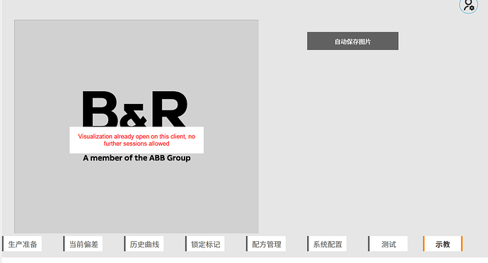

# How coud I show the mappVision page in the mappview page
**URL:** <https://community.br-automation.com/t/how-coud-i-show-the-mappvision-page-in-the-mappview-page/6423>\
**Category:** Controls & Vision\
**Tags:** mapp-view, mapp-vision\
**Created:** [April 1, 2025, 5:27am UTC](https://community.br-automation.com/t/how-coud-i-show-the-mappvision-page-in-the-mappview-page/6423 "2025-04-01T05:27:58Z")\
**Posts on this page:** 3\
**Author:** ![jiangp](https://avatars.discourse-cdn.com/v4/letter/j/FF8800/32.png) [@jiangp](https://community.br-automation.com/u/jiangp)\
**Post date:** [April 1, 2025, 5:27am UTC](https://community.br-automation.com/t/how-coud-i-show-the-mappvision-page-in-the-mappview-page/6423/1 "2025-04-01T05:27:58Z")
![{A307D320-CB70-4472-91D9-34FF3A831B3E}](https://europe1.discourse-cdn.com/brcommunity/original/2X/e/ec5a6b5b5e4c07ba86fc104e06b8c5bbbb0be524.png)
**Author:** ![vanessaca](https://avatars.discourse-cdn.com/v4/letter/v/FF8800/32.png) [@vanessaca](https://community.br-automation.com/u/vanessaca)\
**Post date:** [April 2, 2025, 12:54pm UTC](https://community.br-automation.com/t/how-coud-i-show-the-mappvision-page-in-the-mappview-page/6423/2 "2025-04-02T12:54:54Z")
Hi @jiangp
here you can find the steps, how to [Embedded mapp Vision HMI in mappView](https://help.br-automation.com/#/en/4/machine_vision/mapp_vision/programming/hmi_thematisch/allgemeines/in_anwender_visu_einbetten.html)
BR
Vanessa
