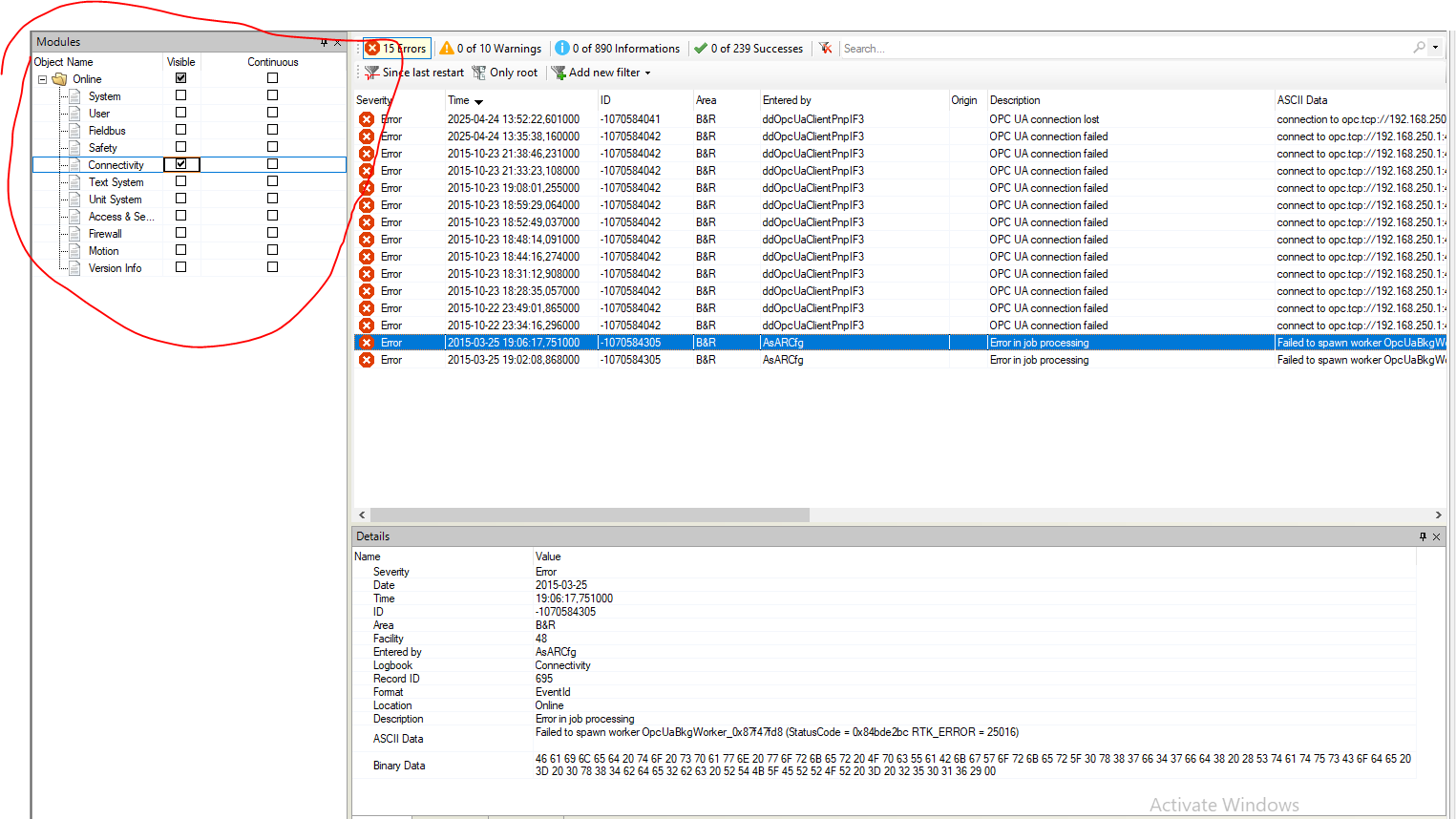

Edit: I just found out what you meant by Connectivity:
 ![image](https://europe1.discourse-cdn.com/brcommunity/original/2X/c/c8cd5dd7ddfe8c2f73419182e97aa78b40a5a3d6.png)
The catagory doesn’t really filter any of the tags for me… Perhaps that means there’s no entries in it?

**Author:** ![Jack\_Lin2](https://avatars.discourse-cdn.com/v4/letter/j/FF8800/32.png) [@Jack\_Lin2](https://community.br-automation.com/u/Jack_Lin2)\
**Post date:** [April 24, 2025, 6:06pm UTC](https://community.br-automation.com/t/how-do-i-format-browse-path-in-opcua-any-using-ua-expert/6731/16 "2025-04-24T18:06:01Z")
Update for this forum post… By default you could only see the System entries in the logger. I didn’t know you could expand the Modules to see the other categories, so I thought there was no other entries. I think this is really silly for Automation Studio.
 ![image](https://europe1.discourse-cdn.com/brcommunity/original/2X/4/4ac7ef11750d4ffc66a871f3043d7a4de67e3e7d.png)
**Post date:** [April 24, 2025, 6:14pm UTC](https://community.br-automation.com/t/how-do-i-format-browse-path-in-opcua-any-using-ua-expert/6731/18 "2025-04-24T18:14:44Z")
Sorry my bad, these errors were from when I already re-entered the variables. These are the errors that come up back when I originally had the InvalidArgument on my OPCUA\_Any.
Here’s what the other error looks like btw, it seems to be Automation Studio continuously trying to reconnect:
 ![image](https://europe1.discourse-cdn.com/brcommunity/original/2X/4/46a9055f257065fb6f078a742ed337628221dff1.png)
The binary data from this screenshot:
-1070584042
The binary data from my last post’s screenshot:
-1070584305
I’ve sent you this exact Logger file with email btw, thanks!
**Post date:** [April 24, 2025, 6:19pm UTC](https://community.br-automation.com/t/how-do-i-format-browse-path-in-opcua-any-using-ua-expert/6731/19 "2025-04-24T18:19:08Z")
Ok I will try to check the logger you send me, for the error you highlight in the screenshot you see the error code in the ASCII Data : 0x80550000
Based on the help link here [B&R Online Help](https://help.br-automation.com/#/en/4/libraries%2Fasopcuac%2Ferror_status_numbers%2Ferrors%2Fstatuscodes_error.html):
Bad\_SecurityPolicyRejected 0x80550000 The security policy does not meet the requirements set by the server.
Please can you check all the connection failed and check the error code ?
For the one highlighted it’s the wrong Security policy.
**Post date:** [April 25, 2025, 8:44pm UTC](https://community.br-automation.com/t/how-do-i-format-browse-path-in-opcua-any-using-ua-expert/6731/20 "2025-04-25T20:44:56Z")
From your loggers file, I see the last error is due to SecurityCheck:
 ![image](https://europe1.discourse-cdn.com/brcommunity/original/2X/2/20fb283dbfb64c6d1d7da62a78877da292d81774.png)
 ![image](https://europe1.discourse-cdn.com/brcommunity/original/2X/c/c59e9dda1ced1e92f68ab95e51666e0419735850.png)
One thing is to check the config you use in UaExpert and copy them to the opcua\_any settings !
