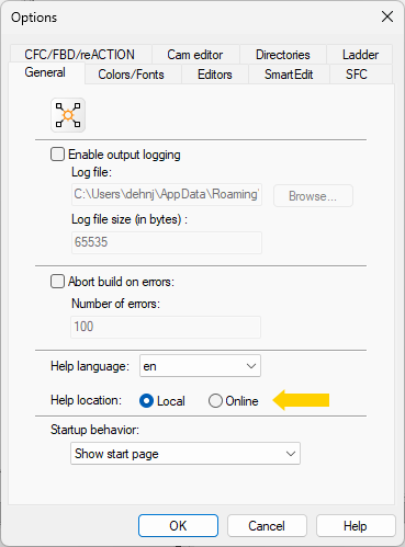

In Automation Studio 6.3, the help system is configured to provide access to our online help website.
In certain situations where internet access is unavailable for various reasons, it may be more convenient to switch to the locally installed AS-Help instead—similar to how it was handled in Automation Studio 4.
**How do you activate local help?**
Go to the **“Tools”** menu and select **“Options”**. Then, change the help source to **“Local”** at the location indicated by the arrow.
