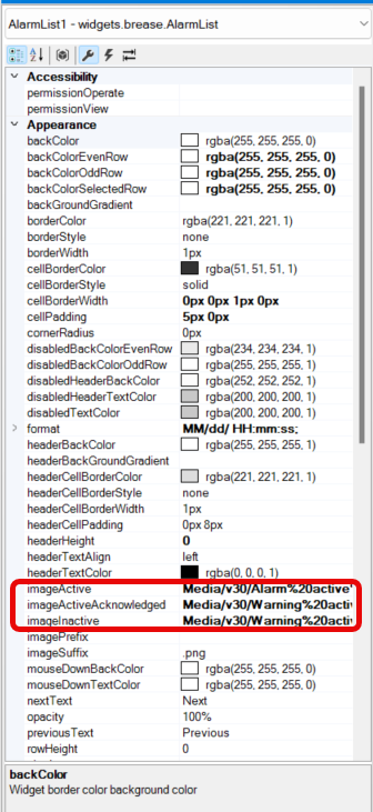

When i use alarmlist widget to display different status of alarms in my system, i find i can only set 3 different icons in the property of alarmlist like below picture:
 ![image](https://europe1.discourse-cdn.com/brcommunity/original/2X/a/ac8dbd020d8dff25248d93e6effc964bfaee239d.png)
But according to the BAM rules, we need to set at least 4 different icons to display the different levels of alarms and faults, so how can i achieve this goal? how to set more icons ? Or just use another widget?

these pictures are used for displaying the alarm state, not for the severity / level of a alarm.
You can use the alarm additional info properties for linking specific icons to alarms, and showing those icons with a alarmlistitem widget inside your alarm list.
Please see here for more information about:
