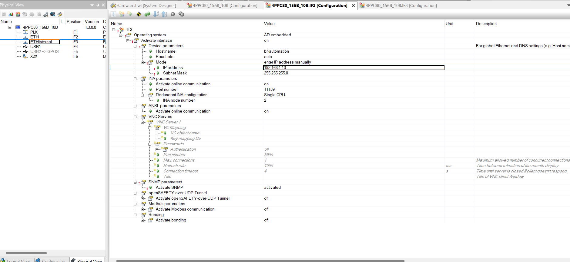

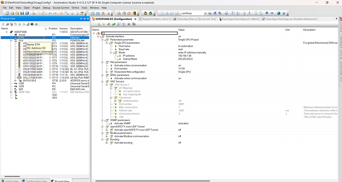

I now want to use 4PPC80\_156B10B to display the mappview screen of the program in X20CP3586. I connected the Ethernet of both and configured it, but the screen shows that access is refused

**Author:** ![jiangp](https://avatars.discourse-cdn.com/v4/letter/j/FF8800/32.png) [@jiangp](https://community.br-automation.com/u/jiangp)\
**Post date:** [October 23, 2025, 1:52am UTC](https://community.br-automation.com/t/how-to-show-a-mappview-page-on-the-c80/8758/3 "2025-10-23T01:52:19Z")

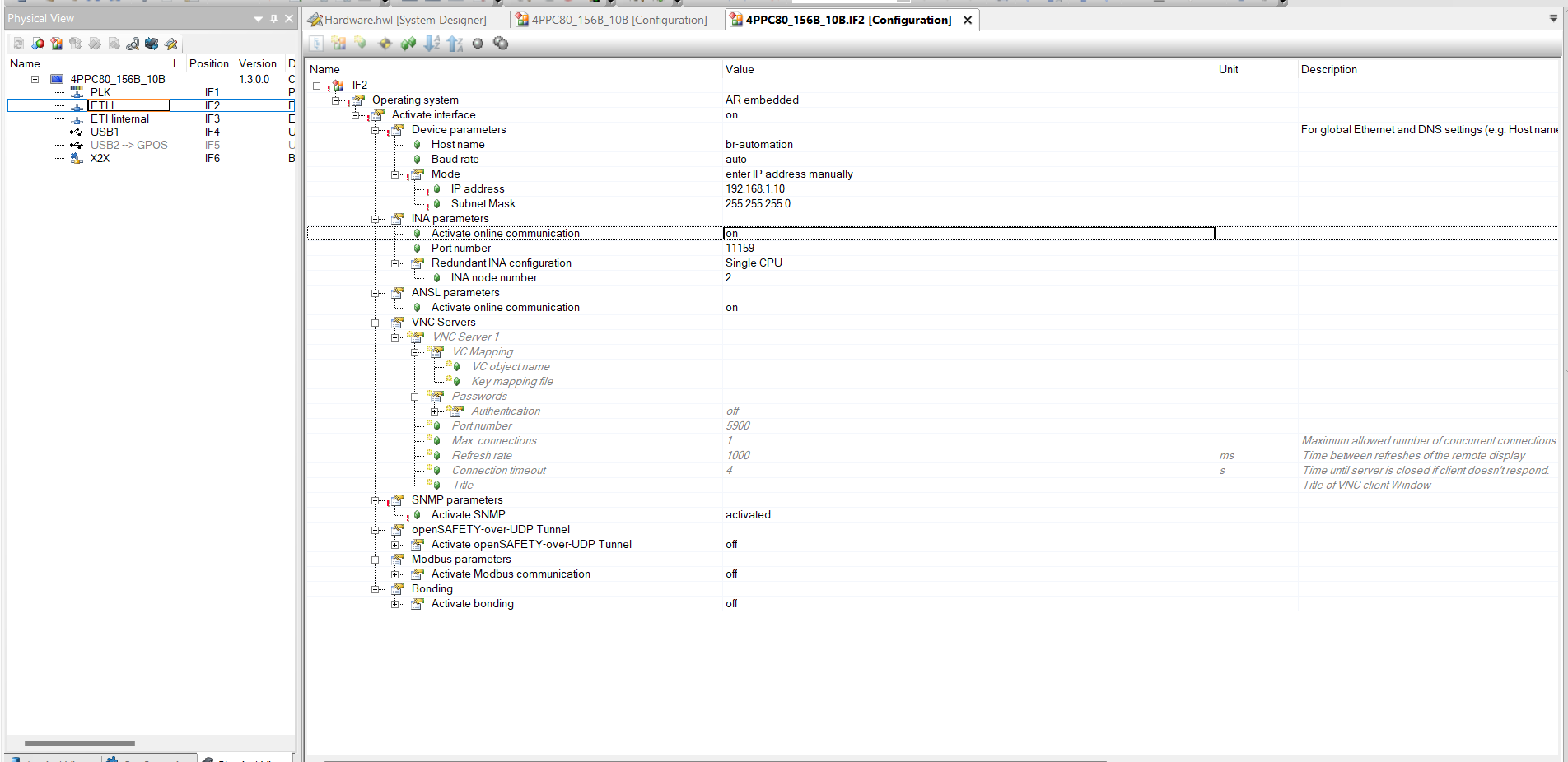

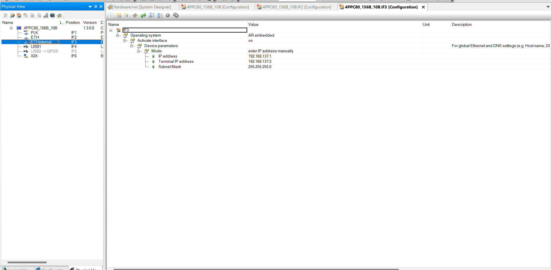

Hi Alexander,
Thank you for your answering! So How should I configure the ETH?
For example, now the IP of the X20CP is 192.168.1.88, so I could get the mappview visualisation on 192.168.1.88:81.
This is the ETH I configured On the PPC80, but it seems not work well.
 ![{328515AA-92F8-40EB-9B40-236752ED802A}](https://europe1.discourse-cdn.com/brcommunity/original/2X/3/30189363ff610edc56d1261113666bfd0cfb0321.png)
 ![{282CB76F-D956-489A-9932-EEB3E92FF924}](https://europe1.discourse-cdn.com/brcommunity/original/2X/3/37ec5fac41c25face60582a095efb80dc54cd645.png)
 ![{2A3BEE3A-98AF-46E6-A8FF-FC86D1C9A538}](https://europe1.discourse-cdn.com/brcommunity/original/2X/3/3263c2f5cc1e5f5bec3dced348fe54d72eed96d1.png)
**Author:** ![alexander.werndl](https://avatars.discourse-cdn.com/v4/letter/a/FF8800/32.png) [@alexander.werndl](https://community.br-automation.com/u/alexander.werndl)\
**Post date:** [October 23, 2025, 6:41pm UTC](https://community.br-automation.com/t/how-to-show-a-mappview-page-on-the-c80/8758/4 "2025-10-23T18:41:57Z")
I’m just asking out of interest, but why are you using a C80( **C** ontroller) and not for example a T80(Terminal) for this task of displaying the visualisation of a PLC? But if it’s just for a test, it can also be set up as desired. Leave the internal ETH set to default. We don’t need it. That’s right, you can set the ETH interface of the C80 as you have already done. Set the ETH interface of the CPU in the same range, e.g. 192.168.1.88, correct, only the last digit must be different. The subnet mask fits with 255.255.255.0 for both devices. The URL of the C80 terminal depends on the visualisation settings.
e.g.
[http://192.168.1.88:81/index.html?visuId=yourVisuName](http://192.168.1.88:81/index.html?visuId=yourVisuName)
See–\>
**Post date:** [October 24, 2025, 8:56am UTC](https://community.br-automation.com/t/how-to-show-a-mappview-page-on-the-c80/8758/5 "2025-10-24T08:56:54Z")

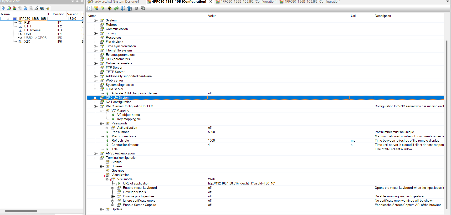

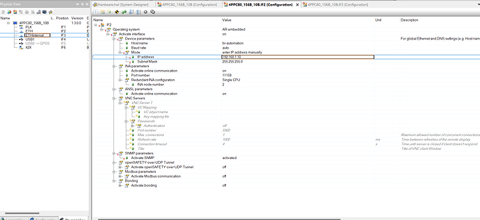

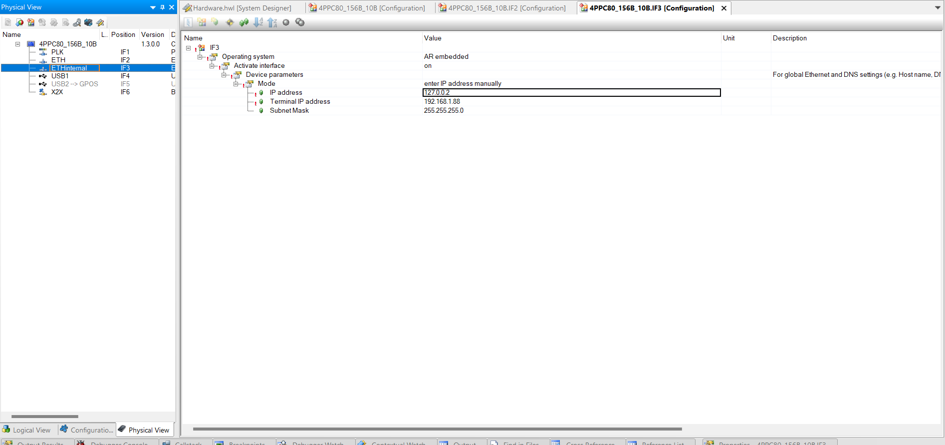

Hi Alexander,
Thanks for your answering! Yeah, I just test because one customer want to do that.
I just configured as the photo, but it still can not be shown in the C80 .
 ![{0086E04C-582F-42C2-8555-8534FC1051C2}](https://europe1.discourse-cdn.com/brcommunity/original/2X/b/b7f0bc4643b336adce79616a2e9e34688321f23a.png)
 ![{C882C15B-9E72-4550-9D71-408B0736B49A}](https://europe1.discourse-cdn.com/brcommunity/original/2X/4/4f3bf15004b3b262779ff9873291998d4eb7d42e.png)
 ![{AAA2411F-442D-4411-AC09-34FC0AAFD380}](https://europe1.discourse-cdn.com/brcommunity/original/2X/c/c4d42518952daba5891a83ec4e05d2d097af51de.png)
 ![{34F85691-A981-4EAF-B60A-4D84C2553FAC}](https://europe1.discourse-cdn.com/brcommunity/original/2X/5/5758953c1a78149af7174831c006457ba589eda3.png)
 ![{B6C1BC07-CBEB-4B32-9B8E-A478E2B9AA08}](https://europe1.discourse-cdn.com/brcommunity/original/2X/a/ab29c427e0d792a32073babb0aff8d8767b8477f.png)
**Post date:** [October 24, 2025, 10:10am UTC](https://community.br-automation.com/t/how-to-show-a-mappview-page-on-the-c80/8758/6 "2025-10-24T10:10:58Z")
Have you attempted to display the visualisation in your browser (Edge or Chrome) on your Windows PC?
The PC’s IP address must also be correct, of course.
And check config –\> [B&R Online Help](https://help.br-automation.com/#/de/4/visualization/mappview/guides/getting_started/getting_started_config/getting_started_config_mvserver.html)
**Post date:** [October 29, 2025, 2:44am UTC](https://community.br-automation.com/t/how-to-show-a-mappview-page-on-the-c80/8758/7 "2025-10-29T02:44:36Z")
Hi Alexander
Yeah， I can show the mappview page in my PC at 192.168.1.88:81
But， when I used the C80, the page is white.
 ![{E43C5381-D217-44B0-945F-1B83689D9A74}](https://europe1.discourse-cdn.com/brcommunity/original/2X/f/f398c5681ba7ffda2b4e82a391c20be922d76bc2.jpeg)
 ![{8AF0017C-72EE-4F80-B96D-3951AE9B5696}](https://europe1.discourse-cdn.com/brcommunity/original/2X/c/cee152edcbc8a8c0241fef77210ce70d98136034.jpeg)
**Post date:** [October 29, 2025, 6:09am UTC](https://community.br-automation.com/t/how-to-show-a-mappview-page-on-the-c80/8758/8 "2025-10-29T06:09:57Z")
That’s a good start.
Unfortunately, there are still many possibilities.
Next, I would try to program a visualisation on the C80 itself and display it via ETHInternal.
I would also activate the option ‘Ignore server certificate errors’ in [Terminal configuration -\>Web](https://help.br-automation.com/#/en/4/hardware/powerpanel_c80/web.html).
And I think the issue of NAT configuration is your problem, see
[NAT configuration](https://help.br-automation.com/#/en/4/hardware/powerpanel_c80/nat_configuration.html)
I hope that helps.
Best regards, Alex
**Post date:** [November 11, 2025, 8:57am UTC](https://community.br-automation.com/t/how-to-show-a-mappview-page-on-the-c80/8758/12 "2025-11-11T08:57:36Z")
Hi Alexander,
Yeah, I just follow your advise to enable the Source NAT, then it works!
