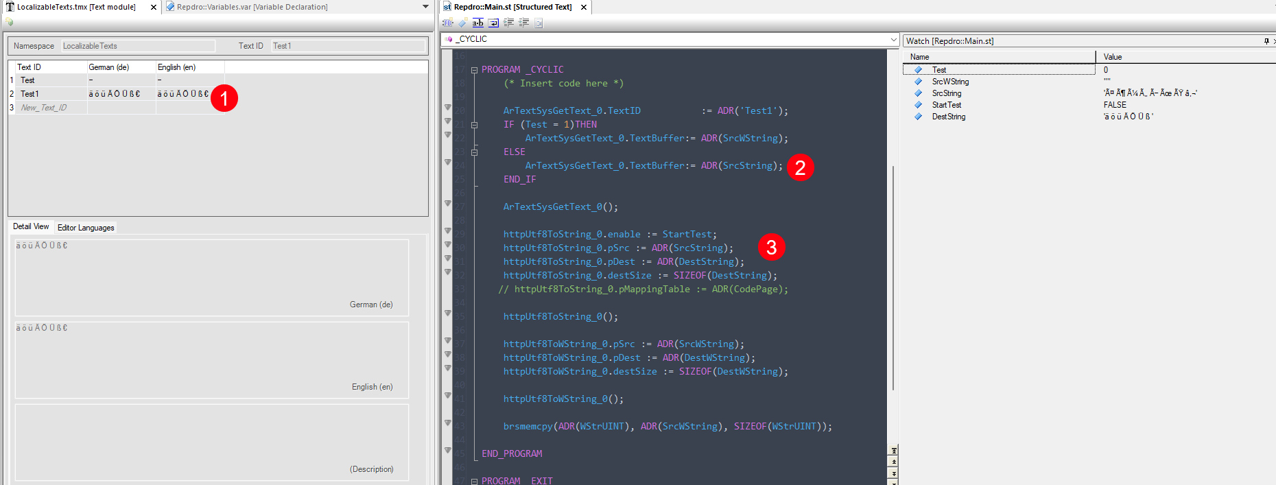

**Author:** ![fabian.pries](https://avatars.discourse-cdn.com/v4/letter/f/FF8800/32.png) [@fabian.pries](https://community.br-automation.com/u/fabian.pries)\
**Post date:** [July 30, 2025, 5:53am UTC](https://community.br-automation.com/t/httpstringtoutf8-mappingtable/7675/4 "2025-07-30T05:53:54Z")
for the characters ‘ä ö ü Ä Ö Ü ß’ and SPACE, no mapping table is required.
These characters are part of the first 255 characters of the unicode table.
Might put this here as reference: [Unicode/UTF-8-Zeichentabelle](https://www.utf8-zeichentabelle.de/unicode-utf8-table.pl)
Please note, that the Watch / MonitorWindow / Debugger Watch is not able to display UTF8 characters outside of the first 255 characters.
You are not allowed to put the characters in your source code since it is not supporting unicode.
I used the textsystem to present the values to my program.
 ![image](https://europe1.discourse-cdn.com/brcommunity/original/2X/d/d508e3af65dd440a63e0567e010838e0a203de04.png)

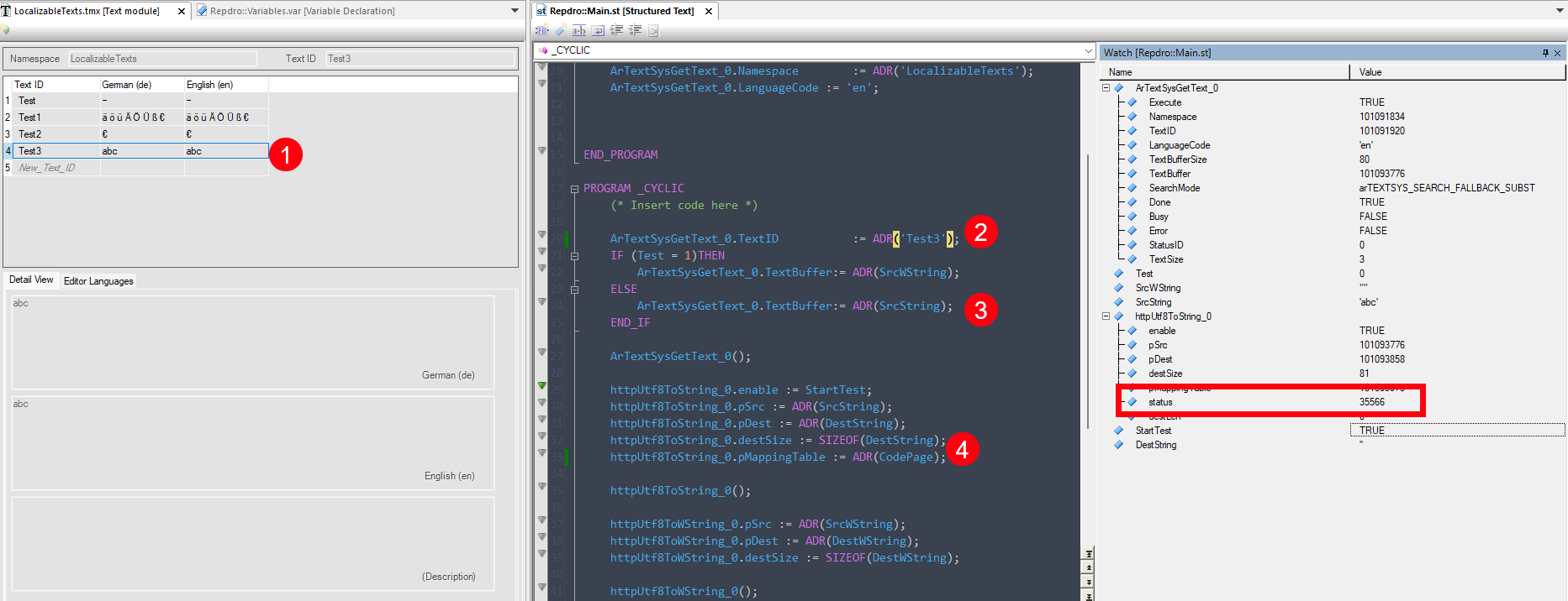

For the ‘€’ you need the mapping table since its unicode representation is U+20AC.
This means the mapping table we have to provide is the “Currency Symbols” starting at U+20A0.
Extracted from the \*.var file:
`CodePage : ARRAY[0..255] OF UINT := [16#20A0,16#20A1,16#20A2,16#20A3,16#20A4,16#20A5,16#20A6,16#20A7,16#20A8,16#20A9,16#20AA,16#20AB,16#20AC,16#20AD,16#20AE,16#20AF,240(0)];`
Now the functionblock converts the characters from the source using this mapping leading to the following:

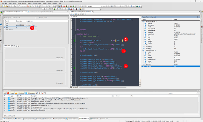

 ![image](https://europe1.discourse-cdn.com/brcommunity/original/2X/e/ef876a9235ef846b27e58f250002b1fdf70c6515.png)
Other characters are no longer supported, since the mapping fails.
 ![image](https://europe1.discourse-cdn.com/brcommunity/original/2X/b/baf737e62cc3ed34d95679619e68cbcaae5f200b.png)
You might want to switch to the httpUTF8ToWString conversion since there is no mapping table required. From the WSTRING it is easy to convert it back to a string using the WSTRING\_TO\_STRING function in ST.
BR Fabian
