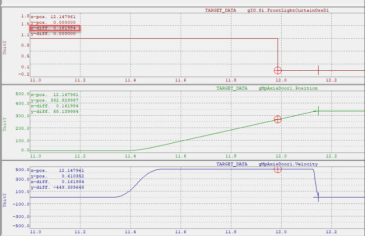

Hi @veeresh.suranagi ,
few questions focus on servo drive:
1. Which B&R drive do you have? Standard ACOPOS/ACOPOS P3/ACOPOSmulti…
2. Do you have holding brake mounted on the motor?
3. Have you configured a quickstop on the axis?
4. Can you trace E-stop signal/actual axis position and actual axis velocity?
For example:
 ![image](https://europe1.discourse-cdn.com/brcommunity/original/2X/2/23c95a3fd8b4ecfeebb3f50fa7e4ffb0d461aba6.jpeg)
Motor commutation stops immediately when STO is activated. Then the motor holding brake is engaged and it stops the motor movement.
It will wear out the motor holding brake.
The correct way to handle e-stop is to use the quickstop function to stop motion (well controlled), then activate STO with a delay
For example on the standard ACOPOS you see an input for quickstop
