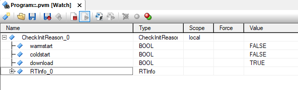

Did a simple test just as example, should work like described.
I implemented a FB using the named functions:
 ![image](https://europe1.discourse-cdn.com/brcommunity/original/2X/0/03150ae3906a762c7e85d5849dda7d5e95e8563a.png)
 ![image](https://europe1.discourse-cdn.com/brcommunity/original/2X/1/134134ecabd3ce2366f8f5af23278e5ba6ae304c.png)
Called the FB in the INIT of a program:
 ![image](https://europe1.discourse-cdn.com/brcommunity/original/2X/6/61491fb6d2f1a7d77a300db54f5d25709d0c9a29.png)
Here’s the output when INIT was triggered by warm restart …
 ![image](https://europe1.discourse-cdn.com/brcommunity/original/2X/1/1e4a8d311d346ce2220b8ec3cdf5f492dcbf3fec.png)
… or when triggered by download …
 ![image](https://europe1.discourse-cdn.com/brcommunity/original/2X/8/8398538fa3600a28b8c22cb26165b5dadd7dace4.png)
… or when called in cyclic instead of init.
 ![image](https://europe1.discourse-cdn.com/brcommunity/original/2X/0/0664cd317eb411aca418bf38f357c8c657a2a7df.png)
