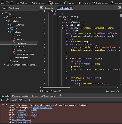

inheriting widgets was fairly easy with the old WDTC, but with 6 this has become more difficult. Do we have any example what the correct way of inheriting standard widgets would look like? I am struggling with define and function calls and what files I need to copy and what files I can reference. An example for a more advanced widget ex. DropDownBox would really help.

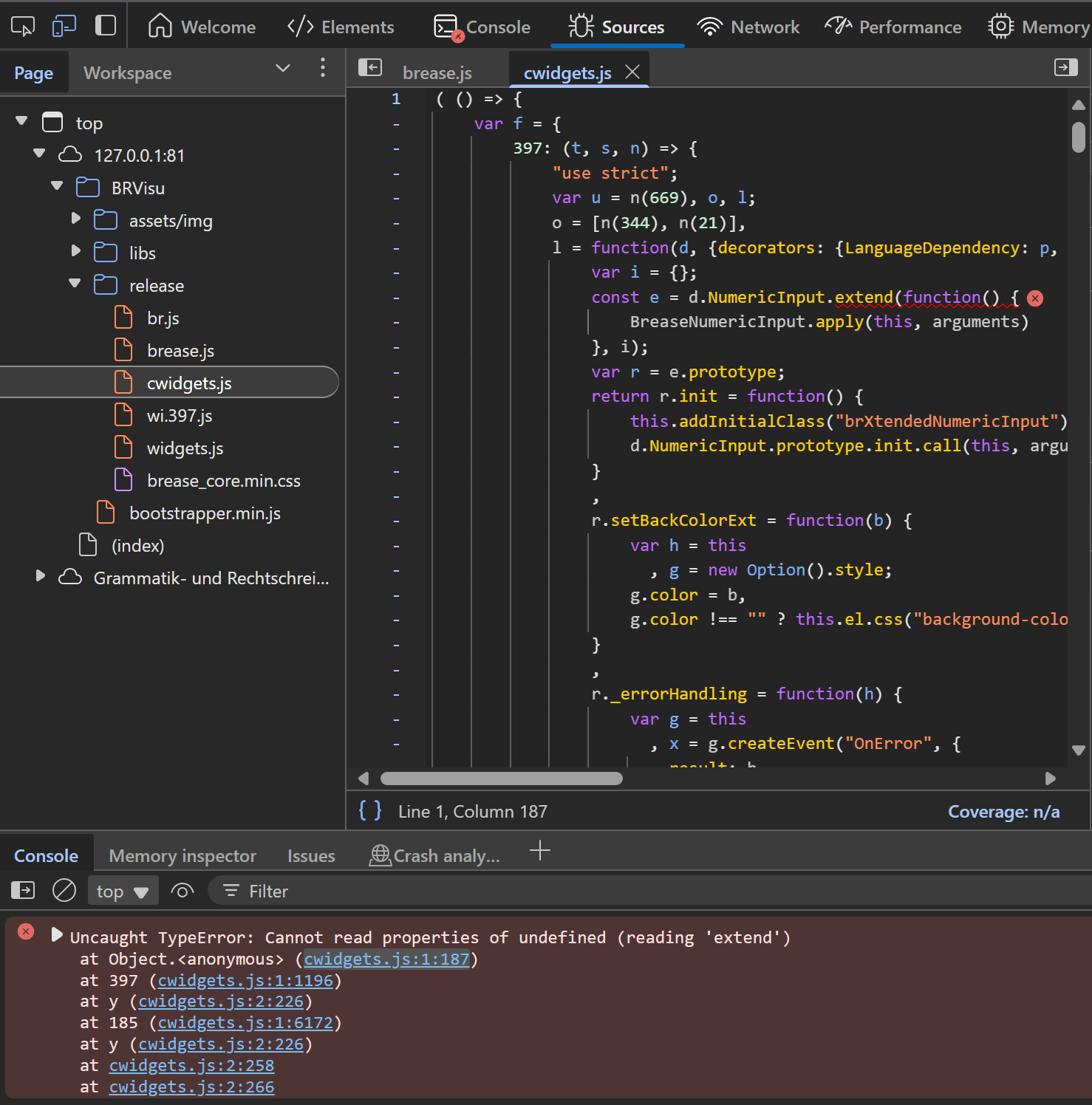

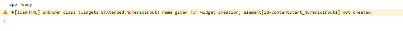

Hi Florent,
I tried to copy the whole widget but that does not work either. Inside the lib are other references back to the standard brease that fail. I am back to the numeric widget but I cant even get that to work…I followed the documentation for inheriting widgets but something is still missing. AS opens fine but I cant add the widget to a content and when I use the text editor it downloads fine but still throws errors.
[brXtended.zip](https://community.br-automation.com/uploads/short-url/bOjnBL1nhtKHPtIXDly4572RvYg.zip) (67.7 KB)
Here is where I am right now…AS tells me
 ![image](https://europe1.discourse-cdn.com/brcommunity/original/2X/7/7aff87f877e475af912e2f3c3ecbd2b9b993913b.png)
and Browser says
 ![image](https://europe1.discourse-cdn.com/brcommunity/original/2X/0/0b93a6c2ea2e484ee2b3d90c51fa241bdb02e625.png)
I am sure its something stupid and simple but I dont see it…

Hi Stephan,
Did you register your widget ?
From external lib you need to, I didn’t remember if it’s in documentation but here is the way I register my widget in MV6 (at the end of the file of the widget javascript file):
```javascript
    // WIDGET REGISTRATION
    if (window.lib_br?.controller?.widgetRegistry) {
        lib_br.controller.widgetRegistry.define(
            "widgets.3dviewer.ThreejsViewer",
            WidgetClass
    return WidgetClass;
I still don’t know if it’s the correct to do it, but for me it’s working so I think it’s the workaround.

Yes, I solved it with this
[Inheriting basic widgets - Widget Development Tool Chain - B&R Community](https://community.br-automation.com/t/inheriting-basic-widgets/7709)
