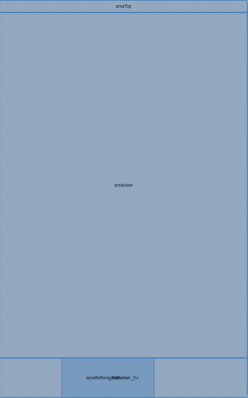

Anyway this is the Layout in my projekt
so as you see on the bottom I have one Area going over the whole width of the display, let’s call this “areaMainBottom”. The Content connected to this area should be the same for all pages.
then I have a second area (the slightly darker area) above this one, somewhere in the middle, let’s call it “areaPageBottom”.
The question now is, can I use the zone in “areaMainBottom” which is overlapped by “areaPageBottom” if the “areaPageBottom” is kept empty?

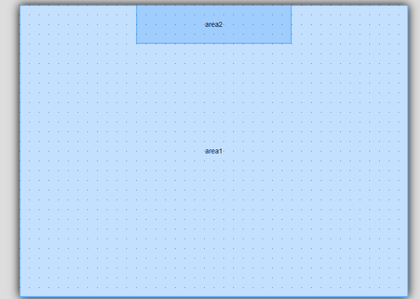

Here is an example, I have this layout:
In this layout the area2 is placed in front of area1.
If I assign to area1 a content that have a button that is placed just at the position of area2, there is 2 possibilities:
  1. In the .page file you didn’t assigned a content to area2, the button will be clickable and visible.
  2. In the .page file you assigned a content to area2, the button will not be clickable but will be visible.
So there is 2 things to check if the area has a content assigned in the page and also check the order of the area in the layout.
Layout is just areas put on top of each others, if there is a content assigned to an area you can’t interact with the under ones. If there is no content assigned to an area she is ignored.
At least I just tested it using AS6.3 and mappView 6.4.
Hope it more clear for you!

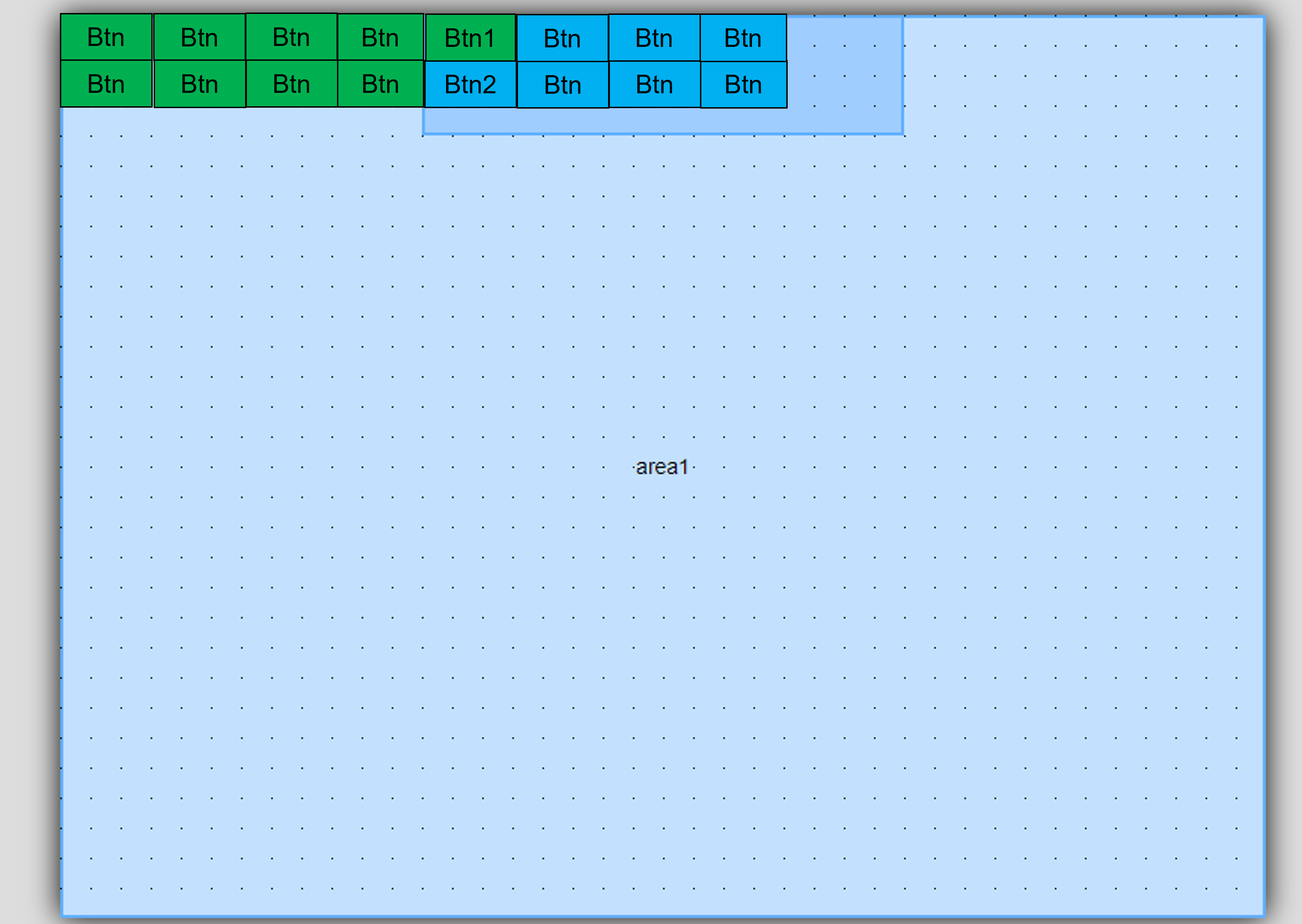

So lets say we have that layout you did. Now I have two rows of buttons (green)
in the area1 assigned content.
normally the space left from area2 is enough for all the buttons, but at some point you need one more button and want to place it next to the other ones. This means the button in area1 assigned content is placed in position of area2.
area2 also have buttons (blue). Because I know that area 1 needs one more button, I keep this space free in area2 content and fill the content just next to the position of the green button with the blue buttons area2 content. But then the green Btn1 is visible but not clickable like you mentioned before.
But how could I define such areas? I woul need to do 3 areas right? area 1, area2 and an area3 for just the button “Btn2”?
