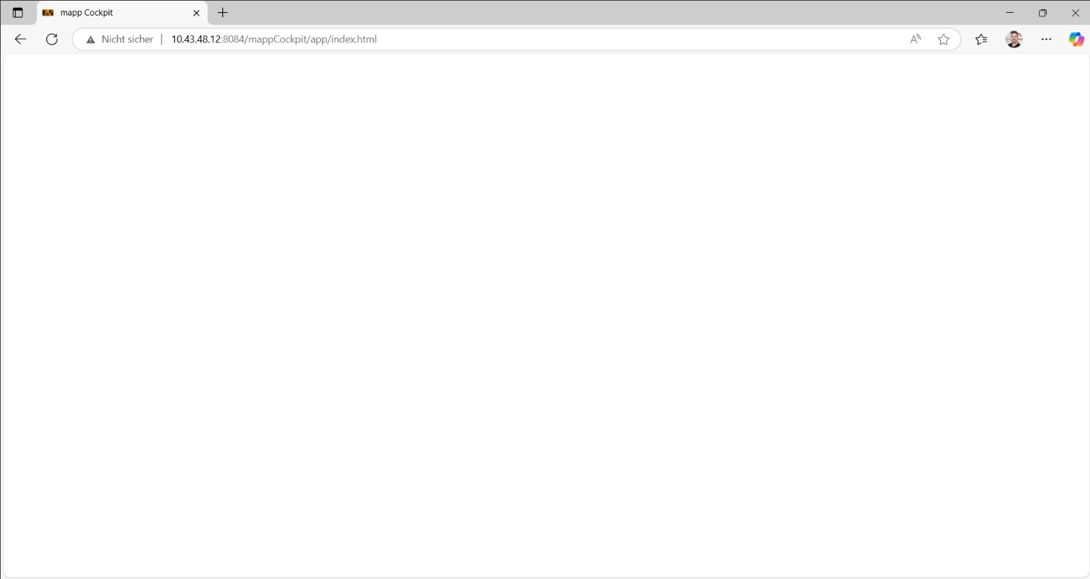

With these versions, changes were necessary to ensure proper browser functionality. Cookies only work properly when the PLC time does match the real current time.
If this is not the case, tools like mapp Cockpit cannot load and only show a blank page or splash screen:

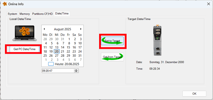

To configure the PLC time correctly, use “Online → Info”, go to tab “Date/Time” and use “Get PC Date/Time” and “Set to Target”.
 ![image](https://europe1.discourse-cdn.com/brcommunity/original/2X/4/49518fe573a344c6ba0d8cbebe9c30d084839e79.png)
 ![image](https://europe1.discourse-cdn.com/brcommunity/original/2X/4/4ce46c0155ee297699eaf4090f632f4269bc8849.png)
This way mapp Cockpit and mapp View can properly function.

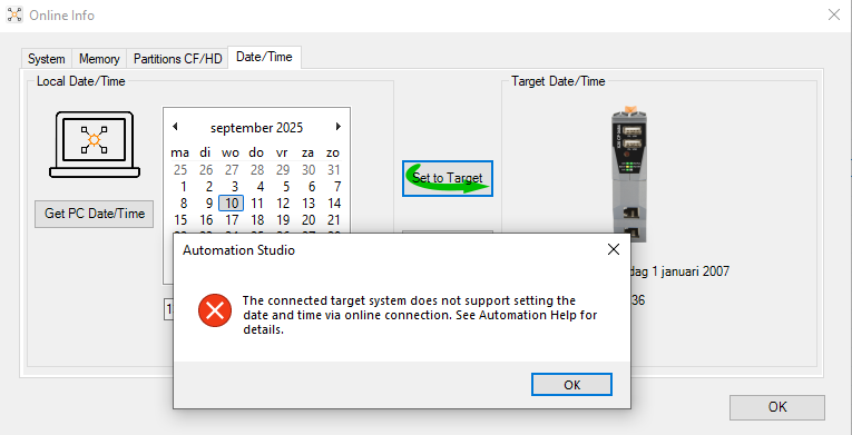

When NTP client is configured, you get:
 ![image](https://europe1.discourse-cdn.com/brcommunity/original/2X/4/43d0a521f1f4258ec679b5219256536ee6d47a69.png)
Date & time can be set when NTP client is off.
