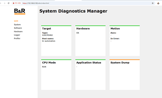

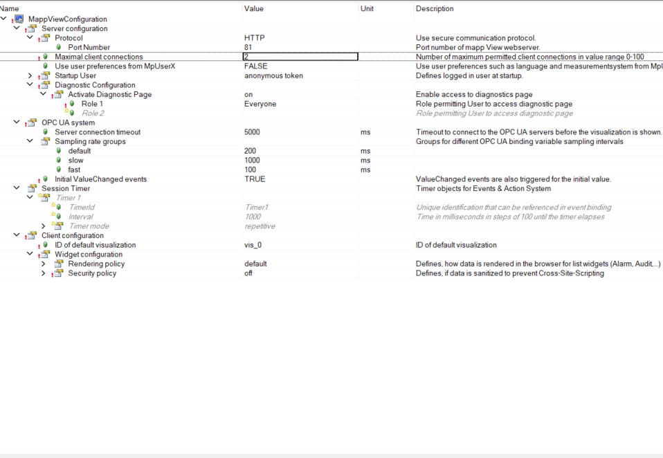

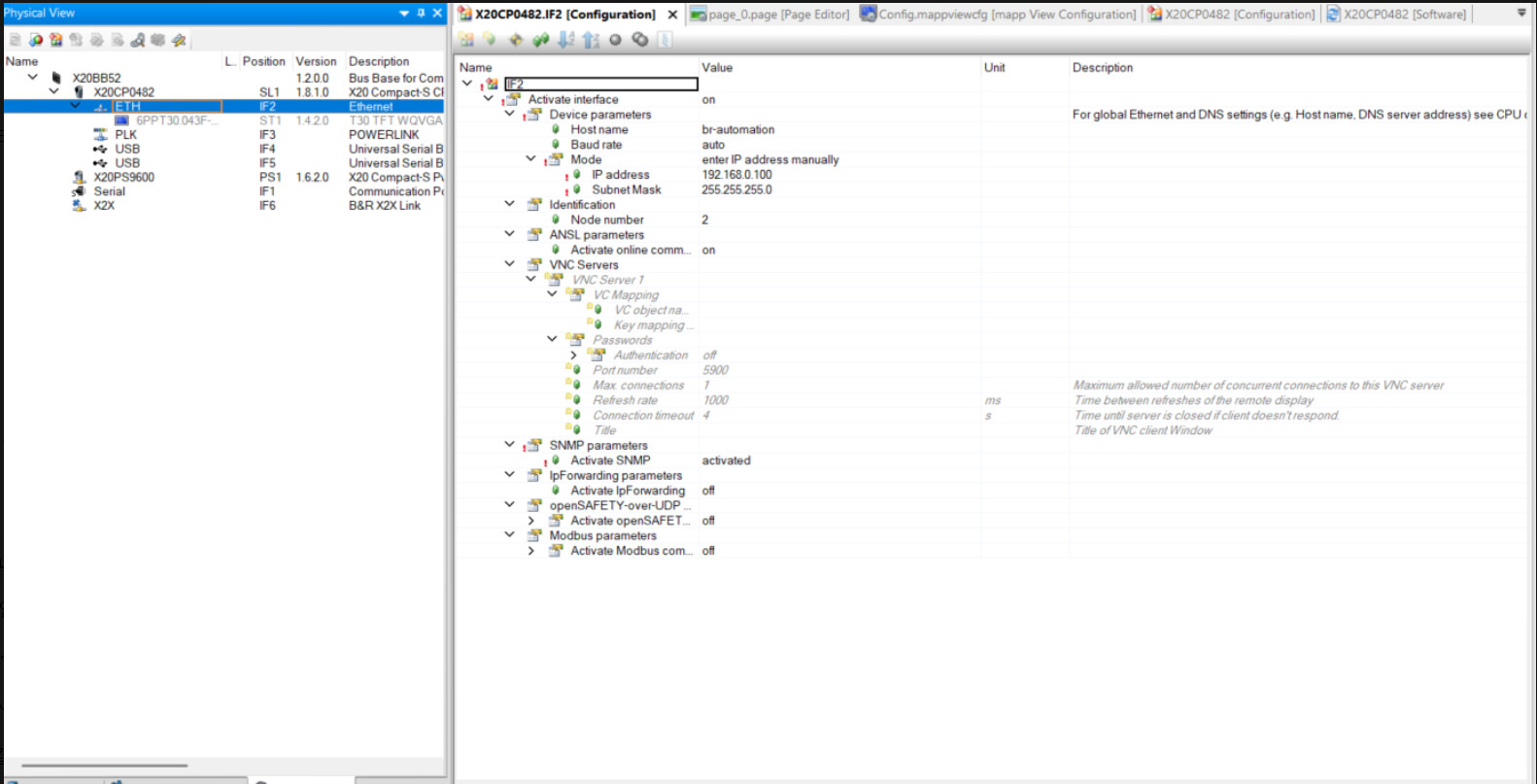

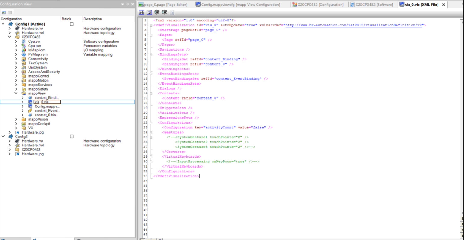

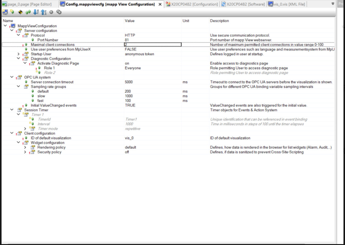

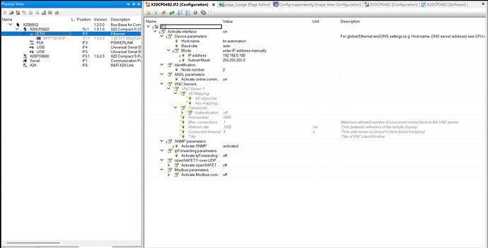

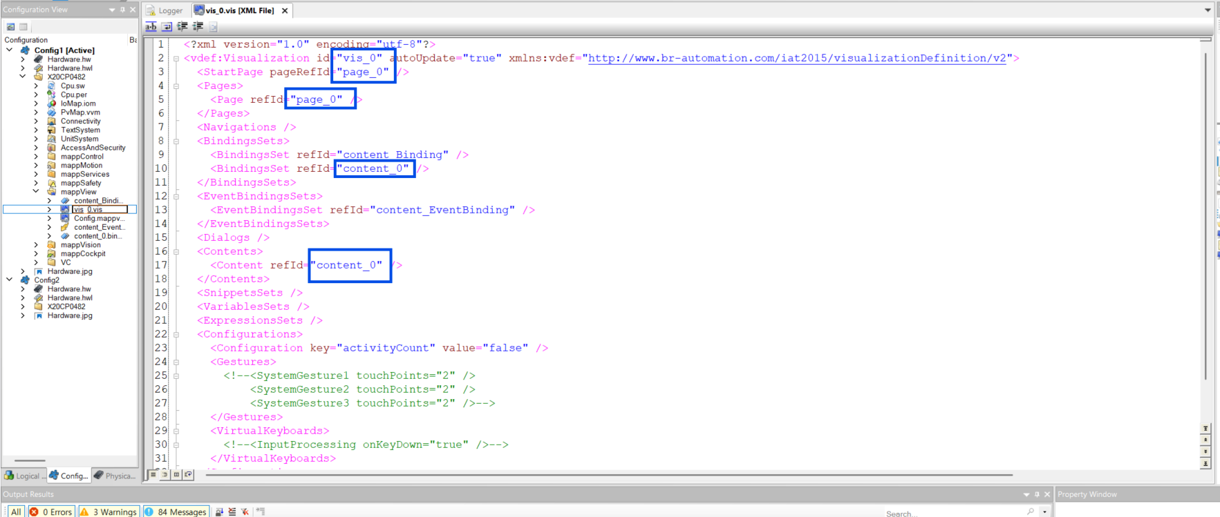

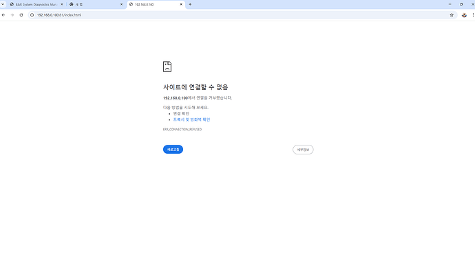

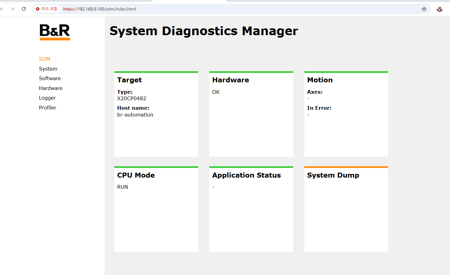

We are testing **mapp View** with **Automation Studio version 6**.
The configuration and runtime settings were done as shown in the attached screenshots.
The project compiles successfully, but when following the steps from the Automation Help, **the mapp View application cannot be accessed from the Chrome browser**.
Could you please advise what additional settings or checks might be required?
Thank you in advance for your support.

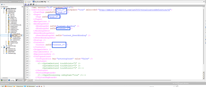

- The visualization object ID (vis\_0) matches the default visualization in mappView configuration.
- The SDM page is now open well
 ![image](https://europe1.discourse-cdn.com/brcommunity/original/2X/5/5874537cd6a9cddfc33074ad31d6efb3bb34a486.jpeg)
 ![image](https://europe1.discourse-cdn.com/brcommunity/original/2X/b/b26bedf4bd6c2865bc3222fc95b02f35f79e838d.jpeg)
 ![image](https://europe1.discourse-cdn.com/brcommunity/original/2X/f/f40e1ba3cc97f58f5df1fbe90101fb0f67d203c4.jpeg)
 ![image](https://europe1.discourse-cdn.com/brcommunity/original/2X/9/9e37025b95b28a45cc7ecb239207e1f984074762.png)
 ![image](https://europe1.discourse-cdn.com/brcommunity/original/2X/a/a2b8838c4060ade2c73c7272830872971cda186b.jpeg)

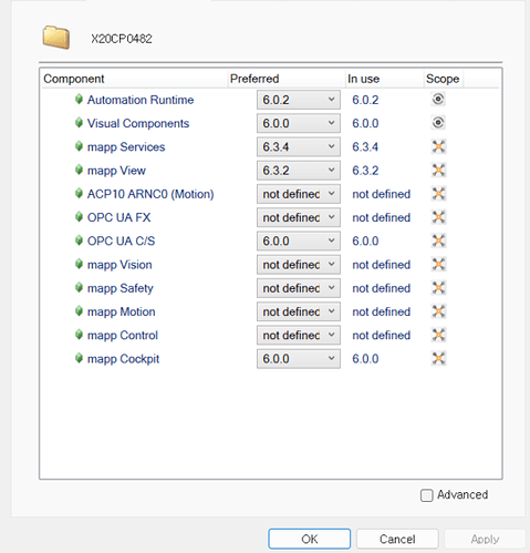

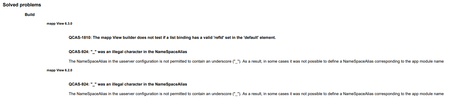

Could you change the mappView version to 6.3? [(Download link](https://www.br-automation.com/en/downloads/software/automation-studio/automation-studio-6/v60-tp-upgrade-mappview-6320/))
I’m not sure, but there is something in the [revision information](https://download.br-automation.com/BRP44400000000000000788046/AS6_TP_mappView_6.3.2_RevInfoE.pdf?px-hash=94abd4ba0c8b37133549edddc258ea76&px-time=1756280070) that seems to be a fix for this issue.

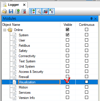

And would you like to check visualization item in the logger for errors? This helps a lot with troubleshooting.
 ![image](https://europe1.discourse-cdn.com/brcommunity/original/2X/a/abd987f2e9bcb74b99d59ea2b1e2ec9c37ead4dc.png)

Hello, thank you for your response. Even after changing the mapp View version to the one you provided, the connection still does not work. Do I need to change all the parts with underscores mentioned in the patch notes in order to successfully launch mapp View in Chrome?”

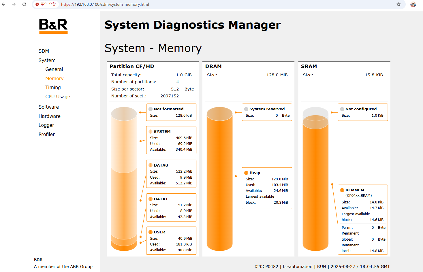

Based on the error in the logger:
 ![image](https://europe1.discourse-cdn.com/brcommunity/original/2X/e/ec3b1ebe98469ce58b981e5d5eac9a9a627b15a2.png)
Your PLC may not have enough RAM available to run mappView, can you share the full logger and maybe a screenshot of the SDM memory page?
What is the PLC you are using?

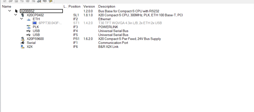

**Post date:** [August 27, 2025, 9:01am UTC](https://community.br-automation.com/t/mapp-view-not-accessible-in-browser-automation-studio-6/8121/5 "2025-08-27T09:01:56Z")
I’ve seen that you are using an X20CP0482. Please check the Hardware guidelines for mappView usage : [B&R Online Help](https://help.br-automation.com/#/en/6/visualization/mappview/guides/performanceguideline/common_hardwareguidance.html)
I’m pretty sure X20CP0482 is too low in performance to run mappView application. Min recommendation for server is X20CP0484

Hello, thank you for your reply. I am currently working with the X20CP0482 CPU.”
 ![image](https://europe1.discourse-cdn.com/brcommunity/original/2X/0/040233443eeb308b0a16bbefa9fd161be526e6ad.png)
 ![image](https://europe1.discourse-cdn.com/brcommunity/original/2X/7/75c31f3754f5b8339d8f48d858ff1ad35d59a19e.png)
 ![image](https://europe1.discourse-cdn.com/brcommunity/original/2X/4/490d6850f07ed8f30dc5fe8dda3334832d98f6b1.png)
**Post date:** [August 27, 2025, 9:17am UTC](https://community.br-automation.com/t/mapp-view-not-accessible-in-browser-automation-studio-6/8121/7 "2025-08-27T09:17:42Z")
Yeah it seems that this PLC didn’t have enough RAM to handle mappView application and maybe CPU too.
I would recommend to use min X20CP0484 as it’s explain in the help.
