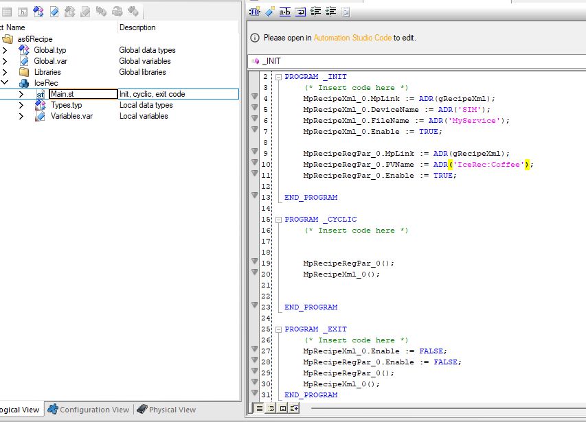

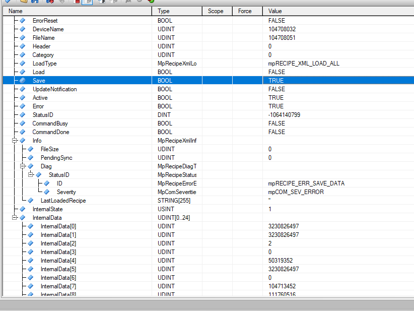

I’m trying to use mappRecipe in AS6.3, but there seems to ​be​ some error. As I try to make the save command, there is an error ID -1064140799. This error ​ID​ seems to tell me that ​I might have made​ a mistake in ​the​ device name or file name. However, ​a similar program has been tested​ in AS4.12, ​where it works well. Is there any other ​possible issue​? Thank you so much for your help.

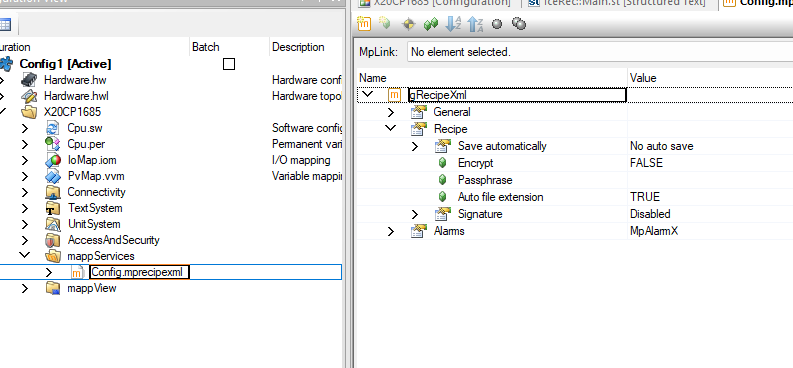

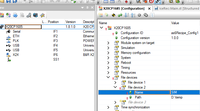

Here is some setting in my project.

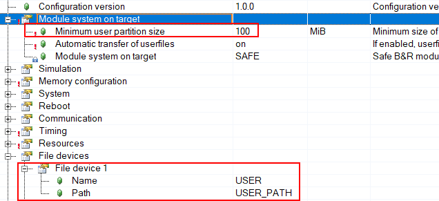

It is not allowed anymore to write on the D: partition since AR A4.91 and later.
You should define a size for the USER partition and use the default file device USER.
 ![image](https://europe1.discourse-cdn.com/brcommunity/original/2X/9/9dd3a985fba104f25685796c4d728c4fc20cf33f.png)
