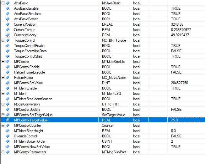

I hope you’re keeping well. I am using Automation Studio 4.12.
I am unable to reduce the value of the velocity of my system when using the model predictive control block MTMpcSisoLite. In the example above, I have shown that I can get to 25degrees/second, then I go to 50 degrees/second, but when I try to return back to 25 degrees / second, nothing happens. If I set a target of 75 degrees/second from that, it works. Can anyone see what I am missing? There are no errors in the logger.
Thanks in advance.

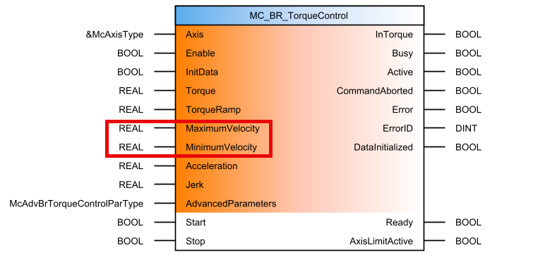

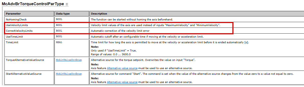

Thanks for the additional information. It sounds like you are controlling the axis with MC\_BR\_TorqueControl as opposed to initiating a MoveVelocity command from MpAxisBasic? In this case I think if you want to change the velocity, you have to use the inputs to the torque control block:
 ![image](https://europe1.discourse-cdn.com/brcommunity/original/2X/8/805b00e0483a6cc3aad8e96776cfcb753cf3cfc3.png)
Also make sure that AdvancedParameters.UseVelocityLimits is false, and I think you’ll also want CorrectVelocityLimits set true. Otherwise, the axis settings will be used instead of the function block inputs.
 ![image](https://europe1.discourse-cdn.com/brcommunity/original/2X/b/b4a29d3ab0870e593e1e2daf1f1f393a32c0a42e.png)

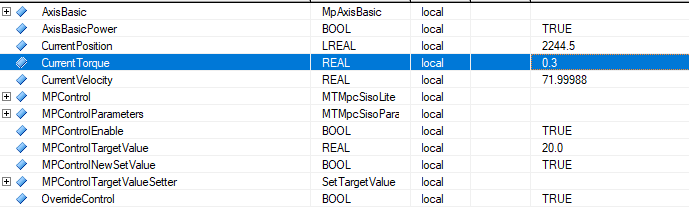

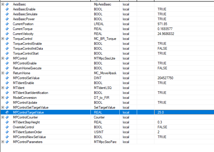

Thanks for getting back to me.
I have attached images of me overriding the control, such that only the axis basic, read position and velocity, and the torque control function blocks are active. As one can see, the values of the torque are able to be increased and decreased without issue.
I have a PID control program too which uses MTIdentLSQ and I am able to decrease the torque in that one (I am also using Axis basic, read position and velocity, Torque control), so I believe that narrows it down to the MPC function block (the model conversion function block doesn’t interact with the torque).
I’ve tried to put delta min negative, but I get an error when I do that.
Just on a side note, the reason that I am controlling the velocity through the torque block is because I don’t want to use the PID control loops on the drive itself - by using this torque control function block, it allows me to just have model predictive control running - no PID.
Thanks for the help so far!

**Author:** ![s\_reilly](https://avatars.discourse-cdn.com/v4/letter/s/FF8800/32.png) [@s\_reilly](https://community.br-automation.com/u/s_reilly)\
**Post date:** [August 20, 2025, 3:13pm UTC](https://community.br-automation.com/t/mtmpcsisolite-not-allowing-velocity-to-reduce/7560/7 "2025-08-20T15:13:18Z")
The solution ended up being very simple - I had delta min set to zero, thinking that it meant it was the lowest change that the process allowed. In reality, it’s the greatest change in the negative direction that’s allowed, so I have it set to +0.1Nm at the moment (the largest negative change allowed is taken in as a positive number which is a bit unintuitive too).
Thanks for the help 😄
