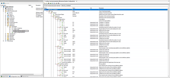

Information about my setup:
- I use mappMotion
- I use the mapp Robotics 3-Axes Delta (A)
- Information provided by my trajectory is: time, acceleration\_x, acceleration\_y, acceleration\_z, velocity\_x, velocity\_y, velocity\_z, coordinates\_x, coordinates\_y and coordinates\_z.
- The time between each trajectory point is 20 ms
- My main CPU cycle is 4 ms
- I use a synchronous motor

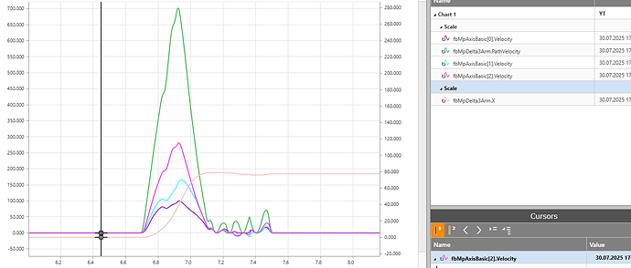

**Author:** ![Nico\_Weber](https://avatars.discourse-cdn.com/v4/letter/n/FF8800/32.png) [@Nico\_Weber](https://community.br-automation.com/u/Nico_Weber)\
**Post date:** [July 30, 2025, 4:48pm UTC](https://community.br-automation.com/t/need-help-replicating-a-trajectory-created-with-a-digital-twin-in-the-plc/7785/3 "2025-07-30T16:48:38Z")

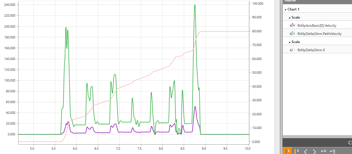

I tried using G93 with G01 combined with the compressor.
I traced the path velocity and axis velocity this got me the following result.
 ![Trace1PathCompressed](https://europe1.discourse-cdn.com/brcommunity/original/2X/8/8122c73f18b94d37a6c5012fbc4db726ca55ad6f.png)
I thought this may be because i hit some limit value i set, but the trace didn’t change when i set the path limits to some very high values:
- Velocity = 2000 mm/s
- Acc and Dec = 20000mm/s^2
The axis limits per axis are:
- Velocity = 360 deg/s
- Acc and Dec = 1800 deg/s^2
I also tried reducing the inverse feedrate to 1/6 of the original value, but that didn’t change the trace. The only thing different was that the velocity spikes were further apart.

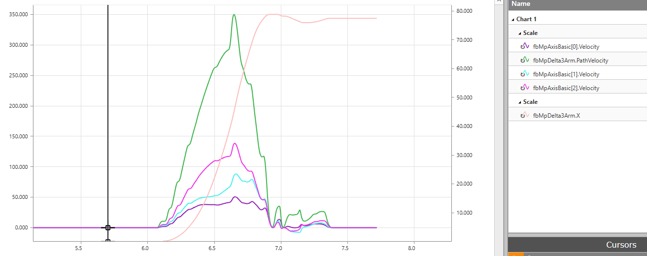

When i use G00 without inverse feedrate the following gets traced:
 ![Trace1PathRapiedCompressed](https://europe1.discourse-cdn.com/brcommunity/original/2X/5/5fc9a881b57014909160027132b2a44e0c0c809b.png)
After trying a few things. I created a trajectory where the max path acceleration will never be above 2000 mm/s^2 with the goal of 100% being below the limit.
The traced data is the following:
 ![TraceLimitedCompression](https://europe1.discourse-cdn.com/brcommunity/original/2X/7/76db74ee5991d1a59656b6f44fad659ee0892d1d.png)
The velocity is way smoother but still spikes, even though it should in theory never get close to the limit values.
Next, i traced the same path but with G00 active. This gets a smoother trajectory:
 ![TraceLimitedRapidCompression](https://europe1.discourse-cdn.com/brcommunity/original/2X/8/8acd708c9d0af96c8e0caa992a1fd2c5f09b3149.png)
What could be the reason that my trajectories are not getting smoothed especially for my first trajectory.
Only using G00 with compress is sadly not an option because i need the exact or almost exact vel and acc at specified times.

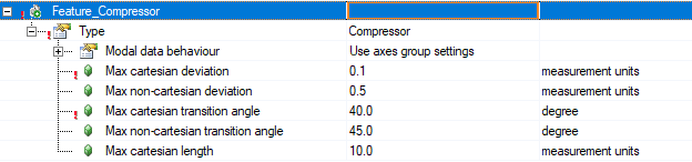

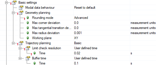

The following are my program code, my axisGroup setting and compressor settings.

 ![AxisGroupSetting](https://europe1.discourse-cdn.com/brcommunity/original/2X/2/2b2c55cade11d98b3aa3abe7e0d327f7b2c781a3.png)
 ![CompressorSettings](https://europe1.discourse-cdn.com/brcommunity/original/2X/1/1607430cfcf36d90623694a8438ae7cca89317c5.png)

i currently have not so much time to go over the whole topic… but i will try to give some short ideas.
If you have enought calculation Power on the PLC you can Reduce the LimitCheckResolution to the Interpolation Time. 0.004s This will improve the Velocity Profile, because the PathGenerator does the calculations more offten. But this will reduce your MaximumStop-Trajectory and increase the Load on the PLC.
I am not sure if there are more helpfull tips if using the Trajectory Planer of MappMotion.
If you can manage to generate your positions in the 4 ms distance instead of a 20 ms distance you can directly feed the positions to the Robot via “MC\_BR\_OnlinePathInfluence\_N”

I tried setting the LimitCheckResolution time to the Interpolation time of 0.004s. This led to a lot of small velocity spikes covering the whole velocity trace. But I will play with it some more.

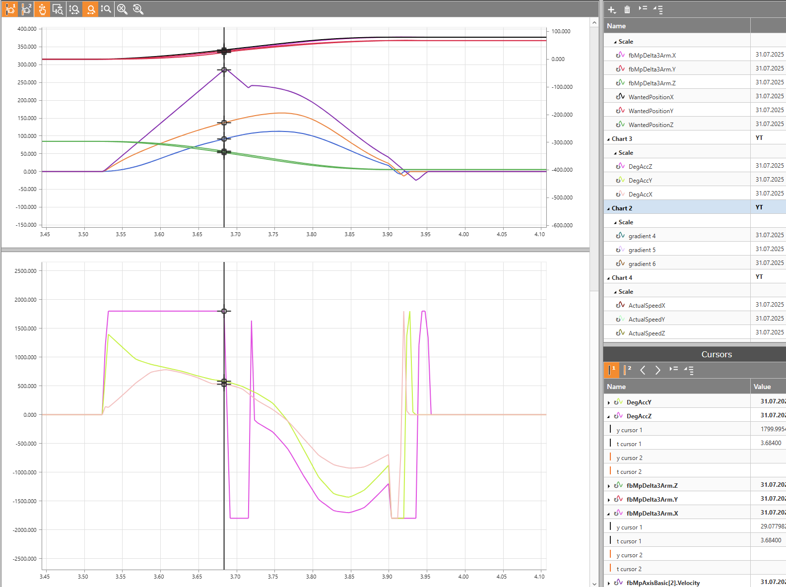

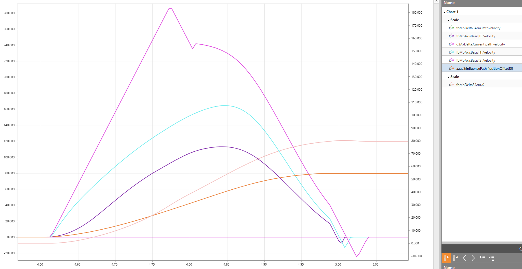

**Post date:** [July 31, 2025, 3:46pm UTC](https://community.br-automation.com/t/need-help-replicating-a-trajectory-created-with-a-digital-twin-in-the-plc/7785/8 "2025-07-31T15:46:09Z")

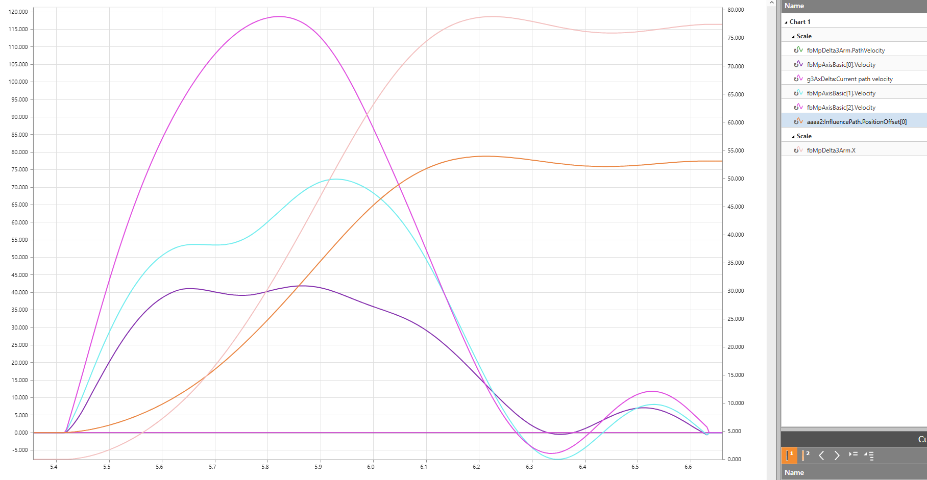

i tried your suggestion with the “MC\_BR\_OnlinePathInfluence\_N” and it kind of worked.
I used cubic spline interpolation to get my positions every 4 ms. Then I calculated the offset and put it into the function.
My traced data now looks something like this:
For the path where the max acceleration was never over 2000 mm/s^2.
 ![TraceLimitedPathOnline](https://europe1.discourse-cdn.com/brcommunity/original/2X/3/3b4f0682c4ad025dcd0fdd16088e531cc9e7255e.png)
And for the one that didn’t work at all last time.
 ![TraceSplineNewRatio](https://europe1.discourse-cdn.com/brcommunity/original/2X/0/05ed025379e94cf300d670bedbad2d6c802f79f7.png)
As you can see, there is still a spike in the z-axis velocity curve. Other than that, the velocity curves are almost resembling the ones I expected. The other difference I noticed is that the axis velocities are greater than the ones I expected. For example, in the last trace, the max velocity of the z-axis is around 240, and the spike is around 285. The expected max velocity of the axis was 143.
Could this offset be why my trajectories didn’t work before?
My next question is, what do the spikes mean?
Is this because I’m too close to the axis limits, or is the position offset from one step to the next maybe too big?
Can this be solved via AutomationStudio or do I need to adjust my AI model and limit the possible velocities and accelerations a bit more?
For my last question. I know that the “MC\_BR\_OnlinePathInfluence\_N” only looks at the axis limits. Is it safe to put the trajectories I just traced on an actual robot, or will it get destroyed? I presume the path limits are there for a reason.
I presume the spikes at the end of the traces are because of the end velocity after my last offset position. This should normally be no problem, but the axis velocities are greater than I expected.
**Author:** ![michael.bertsch](https://dub1.discourse-cdn.com/brcommunity/user_avatar/community.br-automation.com/michael.bertsch/32/239_2.png) [@michael.bertsch](https://community.br-automation.com/u/michael.bertsch)\
**Post date:** [July 31, 2025, 4:29pm UTC](https://community.br-automation.com/t/need-help-replicating-a-trajectory-created-with-a-digital-twin-in-the-plc/7785/9 "2025-07-31T16:29:42Z")
The Path-Limits are normaly to ensure a save Process and not to save the mechanic. The mechanic is protected by the axis limits. Some mechanics have also mechanical constrains which are considered in the mechanical description. Delta4Ax 4Ax-Telescope for example.
If you have vacuum gripper you would like to have cartesian limits to ensure you do not surpass your Process forces. In this case the PathLimits are a good option to reduce the mechanical limits to the process.
If you would move a delta as fast as possible you would remove all path limits and move by axes limits. Sometimes this is called Torque-Limited operation.
You should first clarify the issue with the limitation, to improve the velocity contour. But i do not think this would damage your kinematic if the axis limits are set well. The most relevant limit is the torque limit for the axis, because the gear is the most weekest part of the kinematic. The motor peak torque is typicaly higher and must be reduced.
The curve of the Velocity[2] seems running in an Acceleration limit. You can use the calculation function of MappCockpit-Trace Analysis to get the limiting value by differentation. Then you can check your configuration for this value.
I would also recoment to trace much more values like Q1,Q2,Q3 Positions and Velocitys to see if an Axis goes in an Limit. You can Trace inputs of OnlinePathInfluence.Position[0,1,2] to compare it to PCS Positions, to see how good the robot follows your values.
The limit of Variables is currently 32. Don’t spare here.
With the differentiation of the trace you can also check the speed of your Functionblock-Position input velocities.
If the Velocity is higher than expected you may have to check your Point Generator, because this is now mainly the driver for the cartesian movement.
If the cartesian speed is ok, and only axis speed is different the you would have to check parameters of Transformation/Mechanic.
I am happy to see how fast you implemented your point generator. 🙂 well done! Keep Going!
I hope my tips can help you go ahead.

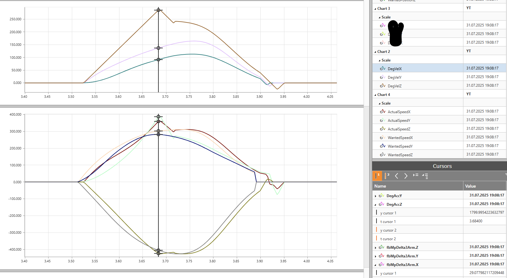

**Post date:** [July 31, 2025, 6:24pm UTC](https://community.br-automation.com/t/need-help-replicating-a-trajectory-created-with-a-digital-twin-in-the-plc/7785/10 "2025-07-31T18:24:47Z")
Thank you for your help so far.
I traced what you sad and could see that the my z-axis was limited through max acceleration.
I also checked how well the robot follows my values and could see a maximum difference of 6 mm. This could maybe be because of the z-axis hitting a limit.
 ![AccChart](https://europe1.discourse-cdn.com/brcommunity/original/2X/c/c7ca7c91e5bd0c48dc96877334b6480215403cd0.png)
The Cartesian speed looked fine for the most part. I could see a spike, but I think that also was a result of my z-axis limit. The axis speed in deg/s is still way too high.
 ![VelocityTrace](https://europe1.discourse-cdn.com/brcommunity/original/2X/8/81bd0df0a174d1448b07a530e7c97e07557164b1.png)
Where can i find these parameters for Transformation/Mechanic.
Are these the one from the ACOPOSmicro Servo Configuration under Mechanical elements? And what do i need to do with them. Could this be a gear ratio problem?
 ![ServoConfig](https://europe1.discourse-cdn.com/brcommunity/original/2X/4/444d8b52f39b1683b260f4bc6e21ff2ebfb0fdad.png)

The Single Axis Mechanical Definitions are not realy relevant in the simulation, as they only have influence of the real motor movement (which you can hardly diagnose in simulation). The Displayed positions are not influenced by this Settings.
The difference between cartesian and joint movement is given by the mechanical Transformation of the mechanic, which is set up by the mechanical Description in mappMotion. Here you have the length of the Arms of the manipulator and so on…
 ![image](https://europe1.discourse-cdn.com/brcommunity/original/2X/1/1d9bc287a170ae71f63b8186547970df031d8006.png)
I am not sure how much expierience you have with the Parameters of Automation Studio
and if you have set up the Robot yourself or if you used a sample pre Configured Project.
You can have a look into this Thread were i explained most of the parameters which are relevant to set up a Robot. The Thread is little longer and goes up to chapter 4-AxesGroups.
[Guide Commissioning](https://community.br-automation.com/t/guide-motion-comissioning-for-beginners/1679)
