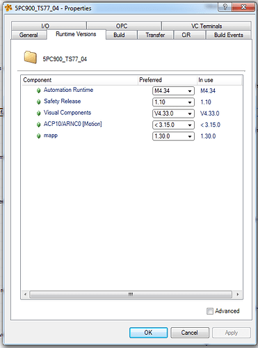

In Change Runtime version ,It is visible as **Mapp Services** but i have an another Project
in which it is named as **mapp** , in that project **MpAxisBasic** is **available** , so how can i do it in this project??
 ![Screenshot 2025-11-27 154120](https://europe1.discourse-cdn.com/brcommunity/original/2X/a/a9bf825ece8cd1ebf37c12f64167e144b0b63dbc.png)
Below is the image in which **MpAxis basic** is available and it is named as **Mapp ,** If It’s Only available in Mapp then how to add it?

your second project made use of [Mapp Legacy](https://help.br-automation.com/#/en/4/mapptechnology/mapptechnology.html) which is based on older versions of ACP10
and which is obsolete now.
Current versions of ACP10 can not use Mapp Legacy.
From my point of view he most promising approach is to build the project on [Mapp Motion](https://help.br-automation.com/#/en/4/motion/mapp_motion/getting_started/getting_started_.html).

Starting with version 5.x, the **mapp Motion** package must be installed to use **MpAxisBasic**. Earlier versions of mapp 1.x handled this differently. Caution is advised, as there are minor differences in usage.

If you are using ACP10 and not mapp Motion, the mpAxisBasic configuration files are added in the Motion folder, not to the Services folder.

Yes but how to enable motion folder ?? i am not able to add it

The Motion folder appears automatically if you choose the ACP10 ARNC0 version.

Also if you add a drive it will whether you want to use ACP10 or mapp Motion. Then there will be a motion folder.
