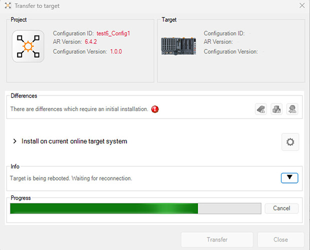

I’ve been trying to connect to a new X20CP1684. I changed the IP and subnet on my PC, and did the same in Automation Studio for the PLC. At first, I’m able to set the IP and ping it successfully. However, once I do a transfer, it gets stuck trying to reconnect after rebooting. If I cancel the process, I see that the PLC has reverted back to its factory IP address, and I can no longer ping it. I’m not sure why it keeps reverting to the default IP, and I don’t know why this is happening, but I suspect it’s the reason the transfer gets stuck.

**Author:** ![Emmanuel\_Flores](https://avatars.discourse-cdn.com/v4/letter/e/FF8800/32.png) [@Emmanuel\_Flores](https://community.br-automation.com/u/Emmanuel_Flores)\
**Post date:** [October 1, 2025, 4:12pm UTC](https://community.br-automation.com/t/plc-ethernet-connection/8558/3 "2025-10-01T16:12:03Z")
Yes, that’s correct. It starts in BOOT, and the IP assigned in this state is 0.0.0.0. I then changed the PLC IP to 192.168.0.55, and it accepts the change—I can still connect, ping it, and see the state as BOOT. However, once I click Transfer, it gets stuck on ‘waiting for connection.’ At that point, I can no longer connect to the PLC and the ping also stops responding. I have switched to Onboard.

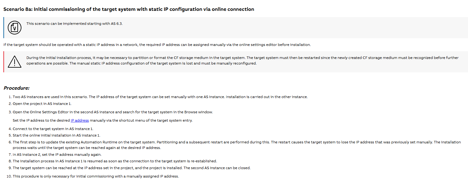

**Author:** ![oliver\_D](https://dub1.discourse-cdn.com/brcommunity/user_avatar/community.br-automation.com/oliver_d/32/257_2.png) [@oliver\_D](https://community.br-automation.com/u/oliver_D)\
**Post date:** [October 2, 2025, 4:58am UTC](https://community.br-automation.com/t/plc-ethernet-connection/8558/4 "2025-10-02T04:58:05Z")
please see AS online help:
[B&R Online Help](https://help.br-automation.com/#/en/6/automationruntime/enhancedtransfer/scenarios/online-intial-operation.html)
 ![image](https://europe1.discourse-cdn.com/brcommunity/original/2X/8/88e527932da240984167a9876091c0e235fef28b.png)
Due to a necessary reboot the PLC will lose its assigned IP adress - then the transfer stalls.
To get rid of this you need to open AS a second time and when the transfer is “stuck” you need to assgn the PLC a new IP adress. If this is done the first AS will resume its download
