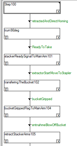

I am newbie in B&R and it is my first project with SFC. Could someone explain me the best practice of resetting SFC program to start step without reset (I mean by using some program blocks). Should I use exception in each step or there is universal way to go to start block (for example go from any block where program stops to Step100). I use AS 3.0.90

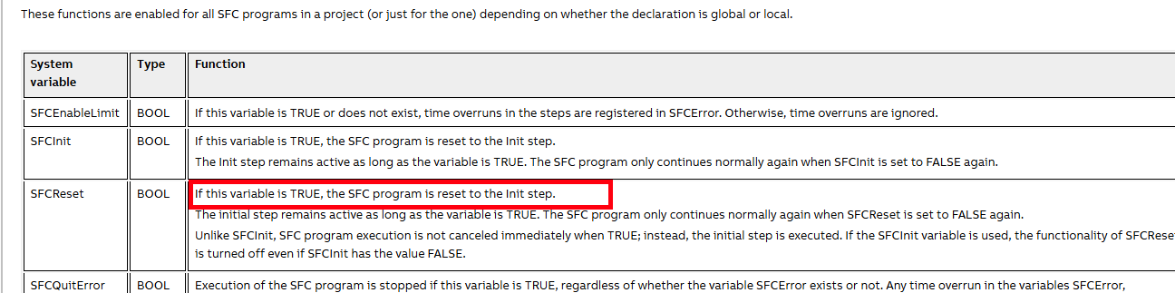

according to [Sequential Function Chart system variables](https://help.br-automation.com/#/en/4/programming/programs/sequentialfunctionchart/programmingmodel_programs_sequentialfunctionchart_flags.html)
this can be done by a system variable:
