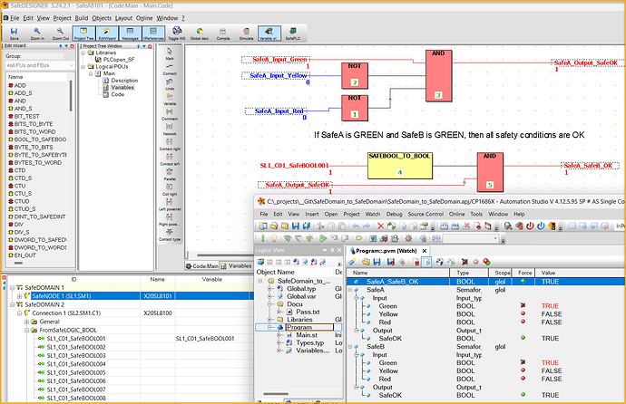

If I wanted to have more than one X20SL8100 in a single configuration, this could be achieved using SafeDOMAIN-to-SafeDOMAIN.
I create HW configuration with two X20SL810x with two Safe Projects :
X20SL8101 - Safe A - SafeDOMAIN 1 , Port 50000
X20SL8100 - Safe B - SafeDOMAIN 2 , Port 50001
 ![image-2025-11-3_14-18-18](https://europe1.discourse-cdn.com/brcommunity/original/2X/3/34d5a4e704c74473ac0a0d666b214d0e31a6e552.png)
And set Connection from SafeDOMAIN 1 to SafeDOMAIN 2.
 ![image-2025-11-3_14-17-52](https://europe1.discourse-cdn.com/brcommunity/original/2X/b/ba3dc3b247a80c9588b05532b50a31264ce25ca0.png)

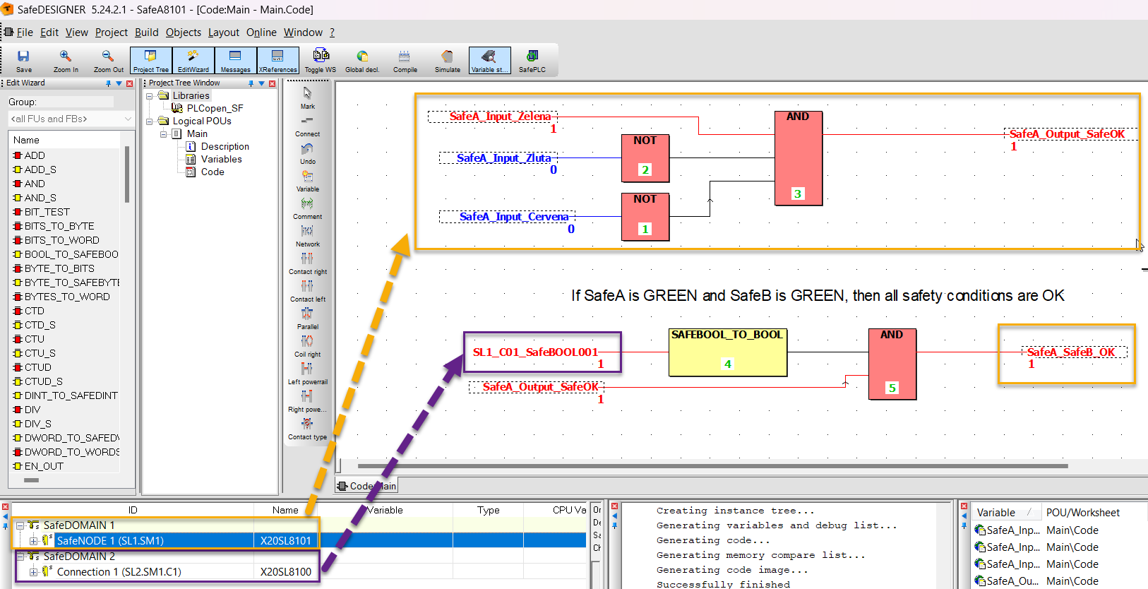

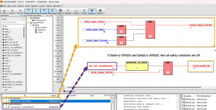

Then set IO mapping for Safe A, and Safe B. We try just simple Safe application.
 ![image-2025-11-3_14-24-13](https://europe1.discourse-cdn.com/brcommunity/original/2X/b/bf5aa49307f89b6bf458e912858281e6712b6e4d.png)
And create simple Safe application.
In Safe application for SafeA I can also see Inputs/Outpust from SafeB (because we configured SafeDOMAIN-to-SafeDOMAIN).
 ![image-2025-11-3_14-38-8](https://europe1.discourse-cdn.com/brcommunity/original/2X/1/1bad2f1f223f97f0043c26d55ce9bdd4228d9595.png)

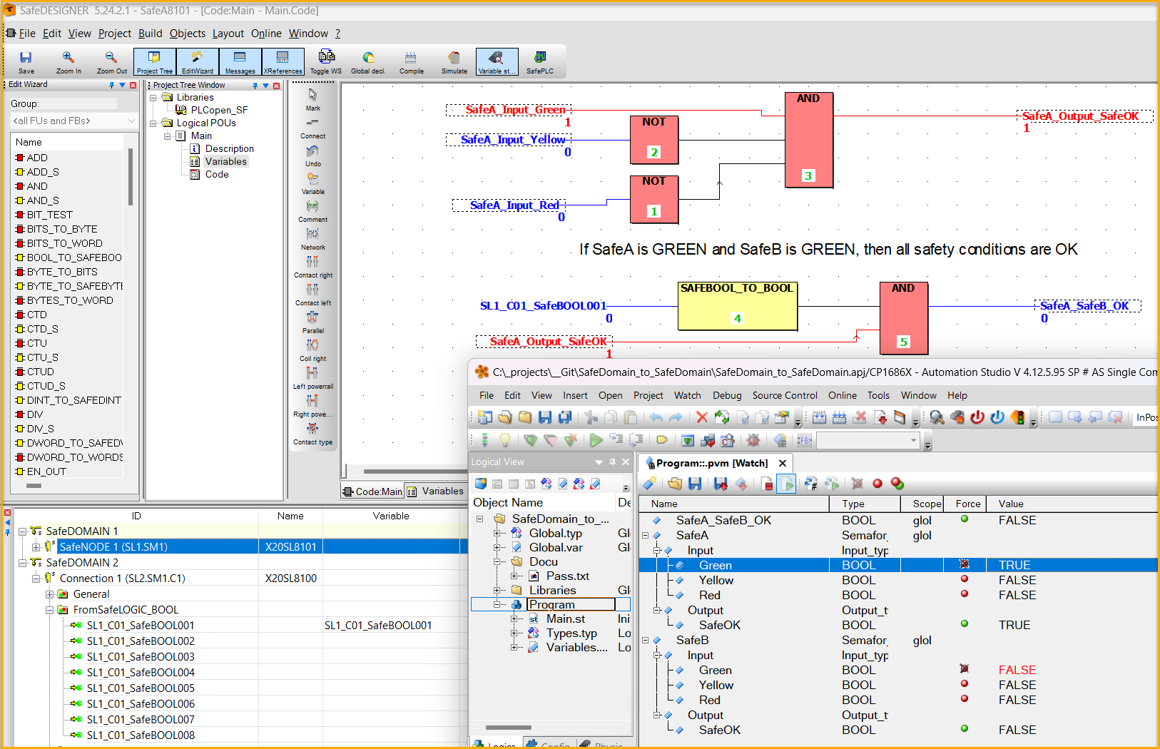

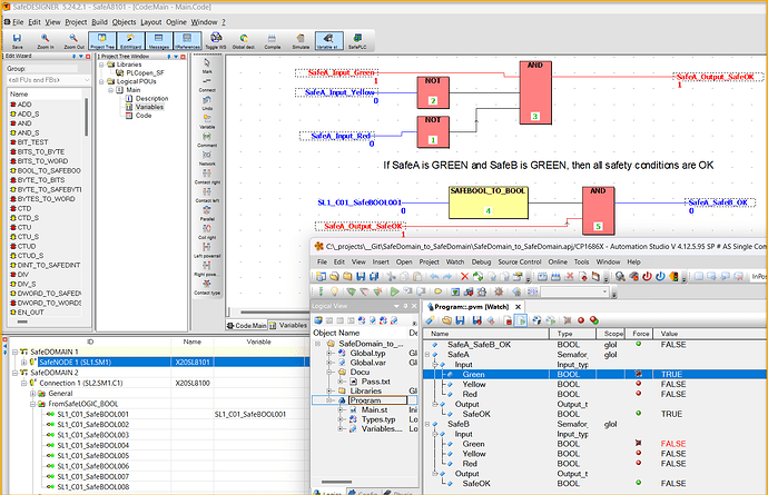

Test :
#### SafeA : Green = 0 , SafeB : Green = 0 ===\> SafeA\_SafeB\_OK = 0
 ![image-2025-11-3_15-31-54](https://europe1.discourse-cdn.com/brcommunity/original/2X/f/f7634c9026fe8f3264a7975ba0564958c34cb5c4.png)
#### SafeA : Green = 1 , SafeB : Green = 0 ===\> SafeA\_SafeB\_OK = 0
 ![image-2025-11-3_15-32-37](https://europe1.discourse-cdn.com/brcommunity/original/2X/3/303f1d121b922d9fa5909ebb7fd0ab5b71a7437b.png)
#### SafeA : Green = 1 , SafeB : Green = 1 ===\> SafeA\_SafeB\_OK = 1
 ![image-2025-11-3_15-33-36](https://europe1.discourse-cdn.com/brcommunity/original/2X/6/65b5e71dcd244db7f63f151f62ff9ada6069da20.png)
