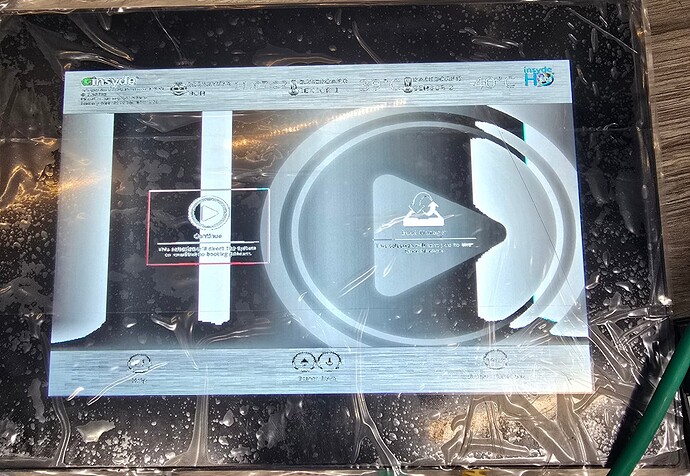

Hello all,
I have a new PPC80 power supply panel with serial number (4PPC80.101G-20B), after unpacking I installed the power supply and first programmed with AS4.12 (runtime P4.93) a problem occurred with the screen (see picture).
I tried changing the runtime but it did not work.
Does anyone have a similar problem and do you have any suggestions on what to try before complaining.
We urgently need the power panel to finish the project on time.
 ![20250915_110603 (1)](https://europe1.discourse-cdn.com/brcommunity/original/2X/8/803b702e63b3ae0d7dcfe2315601de2ffa4ecef4.jpeg)
Thanks in advance,
Mihajlo
**Post date:** [September 17, 2025, 2:11pm UTC](https://community.br-automation.com/t/screen-problem-ppc80/8405/2 "2025-09-17T14:11:35Z")
Make sure that newest hwx file in project is used for C80.
**Author:** ![Mihajlo\_Tatovic](https://avatars.discourse-cdn.com/v4/letter/m/FF8800/32.png) [@Mihajlo\_Tatovic](https://community.br-automation.com/u/Mihajlo_Tatovic)\
**Post date:** [September 17, 2025, 8:15pm UTC](https://community.br-automation.com/t/screen-problem-ppc80/8405/3 "2025-09-17T20:15:06Z")
Dear Jaroslav,
Thank you so much. Quick response and problem solved.
Yes, it works after using the latest hardware version.
