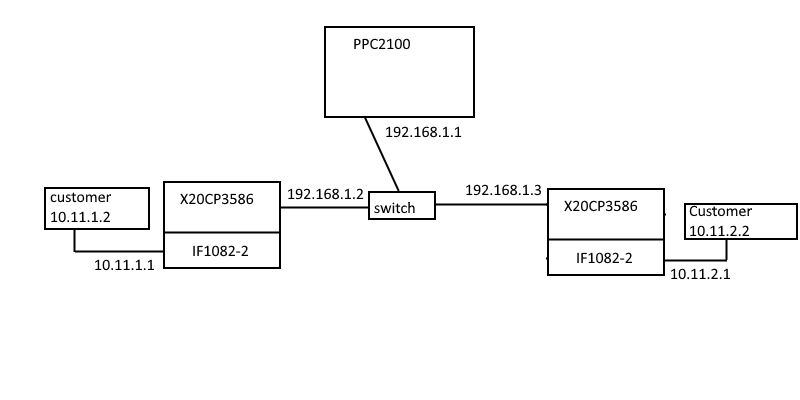

Hi all, I’m trying to create a local simulation of several B&R PLCs connected over a network. This copies a device we have running in the field, but which I cannot access for the time being.
I’ve drawn up a schematic of the network I’m trying to simulate, see below. I’ve managed to get the simulation working of the communication over the switch, in the 192.168.1.x network, using the guide at [B&R Online Help](https://help.br-automation.com/#/en/4/automationruntime/targets/ar000/onlineconnection/online_connection_physicalinterface.htm). This is all working fine, the PPC and PLCs can communicate over OpcUa and ANSL just fine.
Regarding the 10.11.x.x network, a custom UDP protocol is used here, over UDP ports 2200-2210, using the library AsUDP. I’ve tried changing the program so it also uses the 192.168.1.x network, since the use of these specific ports doesn’t interfere with anything else for as far as I know. UdpOpen gives no error, UdpIoCtl gives error 9999 when attemting to bind to the interface, after which UdpClose gives error 35000. I’m in AS4.12.6.106 using AR B4.92.
Now I guess my question is: is it possible to assign multiple IP addresses to ARSim, so I can also simulate the 10.11.x.x network? Or else, how would you simulate something like this?
 ![afbeelding](https://europe1.discourse-cdn.com/brcommunity/original/2X/5/5b90322ce880df6d6619d75ea842ded2ec3daf90.png)

Your simulated network setup is not totally clear. Which devices are ArSim and which devices are not.
You could try IP address 0.0.0.0 for ArSim; see following post.

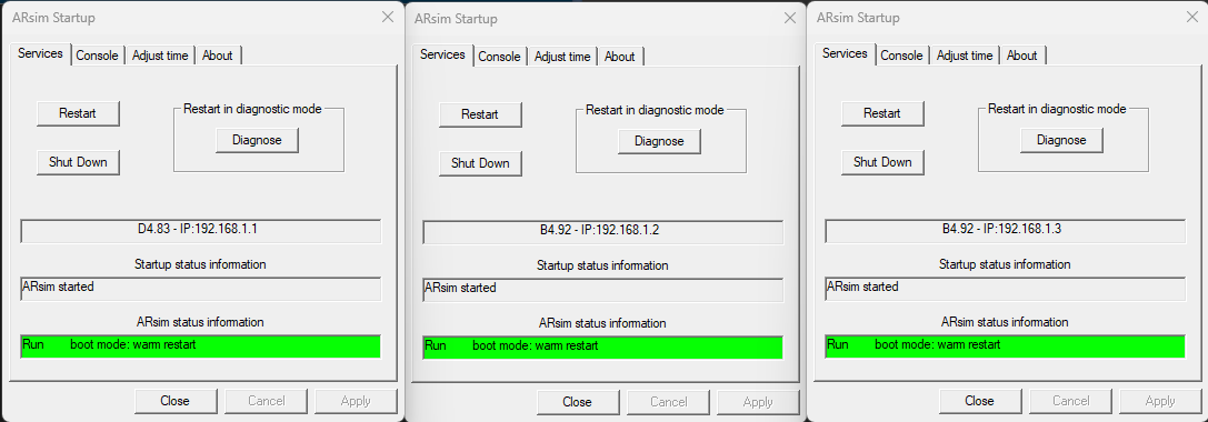

All the devices in the diagram are simulated: the PPC and X20 PLCs (including IF1082-2) are each running in a separate ARSim, making three simultaneous ARSim instances. The customer device is simulated with a local UDP sender/receiver program.
 ![afbeelding](https://europe1.discourse-cdn.com/brcommunity/original/2X/b/ba5fd9862914e505149a53b7de890e0bb01684d1.png)
Changing the simulation IP address to 0.0.0.0 to bind to all interfaces does not fix my problem. Any UDP traffic i send to 10.11.1.1 is now sent to the X20 interface, and not the IF1082-2 interface where I am listening for it.
To reiterate: I’m looking to send UDP traffic to the (simulated) IF1082-2 Powerlink interface, on a different network address than that of the ARSim instance.

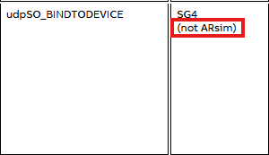

Attempting to bypass the IF1082-2 interface and using IF2 of the CP3586 (that’s IP 192.168.1.2) in my program results in the same issue as before: a 9999 error. Perhaps someone can tell me what function exactly is not being implemented here?
I’m opening a UDP port for sending using `UdpOpen()`, port 0, option `udpOPT_REUSEADDR`. Then I attempt to bind this port to interface IF2 using `UdpIoCtl()`, ident `FbUdpOpen.ident`, ioctl `udpSO_BINDTODEVICE`, pData `ADR('IF2')`, datalen `LEN(DeviceName)`. Calling the UdpIoCtl FB returns the 9999 error.

The function not implemented is the idpSO\_BINDTODEVICE : [B&R Online Help](https://help.br-automation.com/#/en/4/libraries/asudp/fbks/udpioctl.html)
 ![image](https://europe1.discourse-cdn.com/brcommunity/original/2X/2/2899ddd3d10a50b8a47077e2ef3f8e388d175974.png)
**Author:** ![Tom\_Veldman](https://avatars.discourse-cdn.com/v4/letter/t/FF8800/32.png) [@Tom\_Veldman](https://community.br-automation.com/u/Tom_Veldman)\
**Post date:** [June 4, 2025, 2:26pm UTC](https://community.br-automation.com/t/simulation-of-complex-network/7188/8 "2025-06-04T14:26:57Z")
That’s some crucial information that I missed. Thank you very much, this did the trick.
