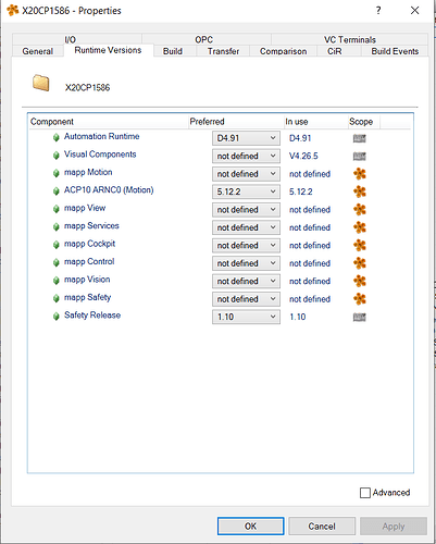

**Author:** ![juncheng.dai](https://avatars.discourse-cdn.com/v4/letter/j/FF8800/32.png) [@juncheng.dai](https://community.br-automation.com/u/juncheng.dai)\
**Post date:** [August 12, 2025, 7:53am UTC](https://community.br-automation.com/t/sk-copy-for-sl8100/7927/3 "2025-08-12T07:53:01Z")
Hello Tommi！
Thank you for your support.
I tried to copy the safety program to one empty safekey. But it doesn’t seem successful.After copied,the S/E turned orange.
Is my operation incorrect or is there a software version requirement?
The video of the operation is in SK-COPY.ZIP.
[SK-COPY.zip](https://community.br-automation.com/uploads/short-url/dINgCeEjXjaKNvRF5NPFmwFVSNs.zip) (5.5 MB)

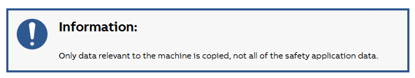

**Author:** ![Zwi](https://dub1.discourse-cdn.com/brcommunity/user_avatar/community.br-automation.com/zwi/32/103_2.png) [@Zwi](https://community.br-automation.com/u/Zwi)\
**Post date:** [August 18, 2025, 7:41am UTC](https://community.br-automation.com/t/sk-copy-for-sl8100/7927/4 "2025-08-18T07:41:24Z")
I don’t think so - the functionality is intended to copy the machine relevant data to a SafeKEY with a new safety program.
That’s why the safety program files are NOT copied to the new SafeKEY.
See help:
 ![image](https://europe1.discourse-cdn.com/brcommunity/original/2X/4/4967090b3f7d727e81ba989e043db5230b81f386.png)

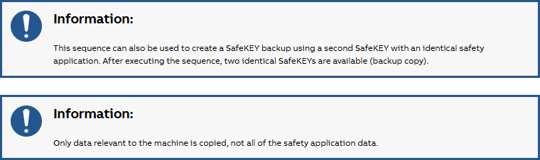

**Author:** ![tommi.piiparinen](https://dub1.discourse-cdn.com/brcommunity/user_avatar/community.br-automation.com/tommi.piiparinen/32/2183_2.png) [@tommi.piiparinen](https://community.br-automation.com/u/tommi.piiparinen)\
**Post date:** [August 19, 2025, 5:22am UTC](https://community.br-automation.com/t/sk-copy-for-sl8100/7927/5 "2025-08-19T05:22:03Z")
At least the same help page your screenshot is from is also saying that it should be possible to copy and have two identical SafeKEYs (backup copy).
 ![image](https://europe1.discourse-cdn.com/brcommunity/original/2X/3/333ec6c2bb33af9b64826a59179e0d3cdf154a5f.png)
**Author:** ![michael\_w](https://avatars.discourse-cdn.com/v4/letter/m/FF8800/32.png) [@michael\_w](https://community.br-automation.com/u/michael_w)\
**Post date:** [August 19, 2025, 7:54am UTC](https://community.br-automation.com/t/sk-copy-for-sl8100/7927/6 "2025-08-19T07:54:43Z")
I also think the help is written very confusingly here.
If you take the “with an identical safety application” part of the sentence, it might imply that this has to be already on there and only the other data is backed-up so the keys are THEN identical. But that’s speculation tbh
Maybe someone can take this thread and use at as an excuse to rewrite the help page 😉
