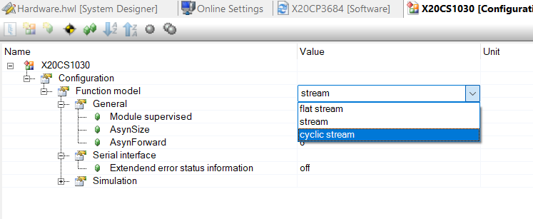

You could try to set the module to cyclic stream. Keep in mind that the module has to pass all data through the X2X bus. That means there will be some delay and limitations in terms of throughput. Some additional information would help to narrow down the issue.

I set the X2X cycle time to 2000 microseconds. I also tried cyclic stream setting and setting other cycles times, but I still get the same behavior. I also tried to omit the ArEventLog logging, but it does not help.
