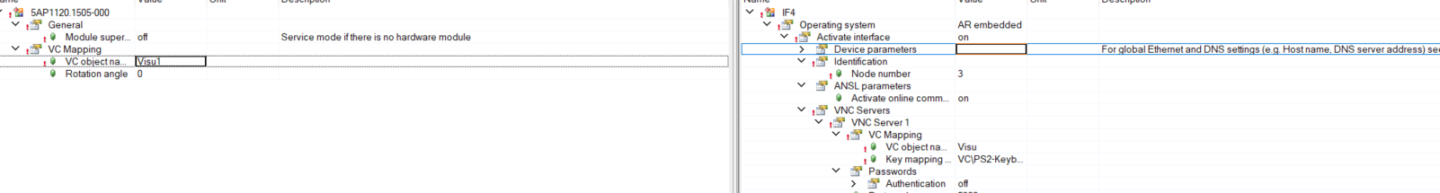

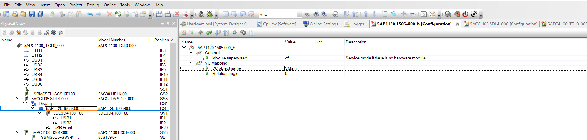

I’m experiencing an issue with running the visualization on the Panel (model 5AP1120.1505) connected to an APC4100. The APC is in “Run” mode, but the visualization does not start. compiled with AS6.3.4
Could you please help me troubleshoot this?
Thanks in advance for your support.
Marcin

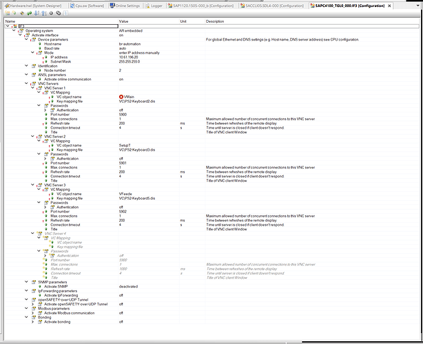

now i see a problem, when i activate the VMain on the Panel on this configuration:
 ![image](https://europe1.discourse-cdn.com/brcommunity/original/2X/a/ad31831ac0f8e78f2e3d6634cba9ea61a67054a5.png)
then on the page with parameters of ethernet1 configuration the VMain is displayed with red dot:
 ![image](https://europe1.discourse-cdn.com/brcommunity/original/2X/b/b440608afa29ad7dd39807464bca384816cc7493.png)
but i don’t know hot to configure it, to display the VC4 VMain visualization

Hello Marcin,
The VNC configuration on the ethernet interface is used for access to vc4 thought ethernet. I tried to replicate the your situation, and only managed to do it, if the there are other ethernet interface already using this vc4 object. Maybe you can check the status form other IF.

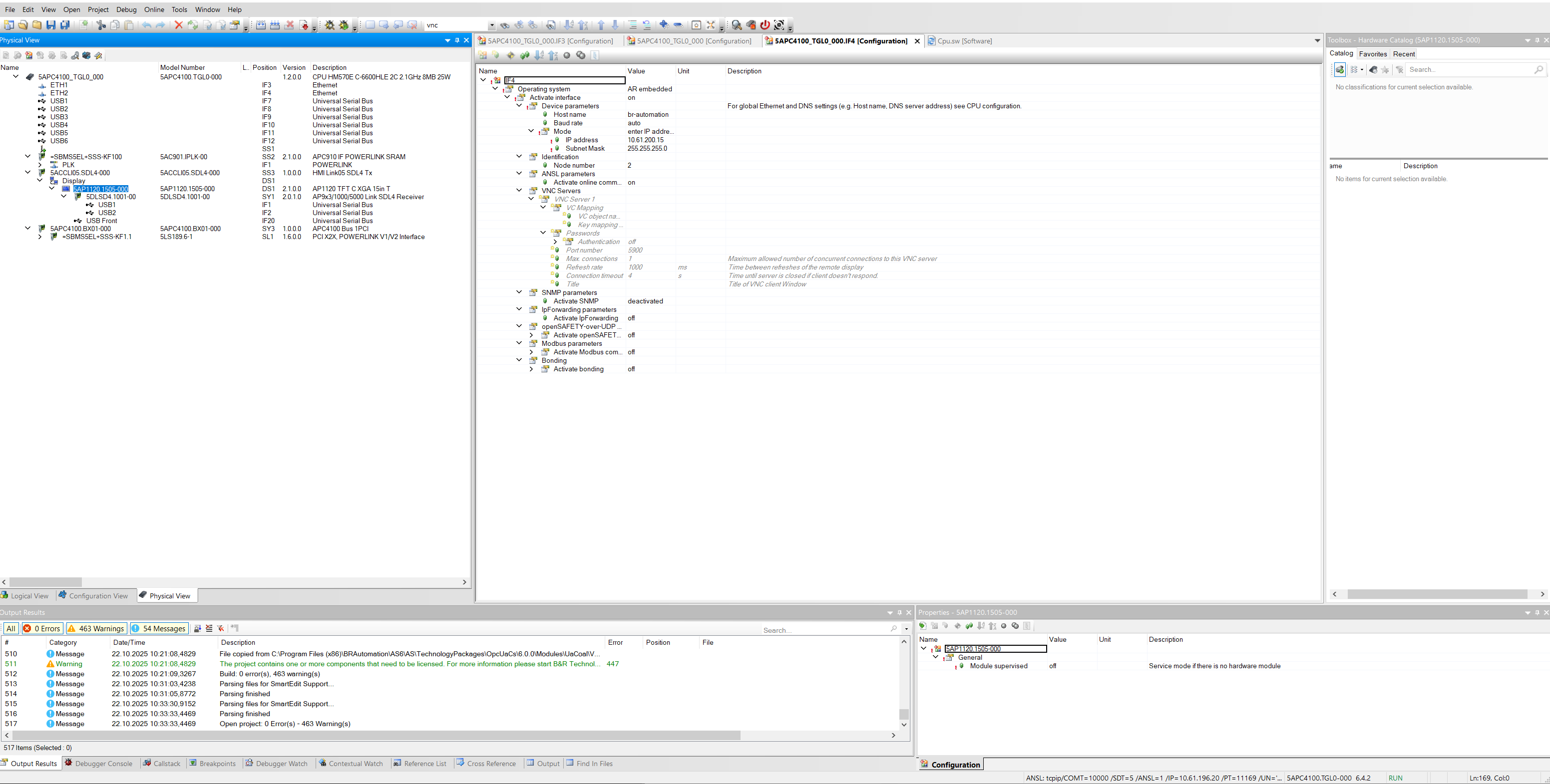

Hello Wenbo,
The problem only exists on APC4100 with SDL4, i have another configuration with APC910, with SDL3 interface and there all is running fine. On the configuration side of ETH2 is nothing connected
 ![image](https://europe1.discourse-cdn.com/brcommunity/original/2X/1/1bad59ec5190eec77b85f7b90fa390022f927d18.png)
I downloaded today also new module version for 5APC4100.TGL0, and then the Connection for VNC on Panel 5AP1120 is not there
