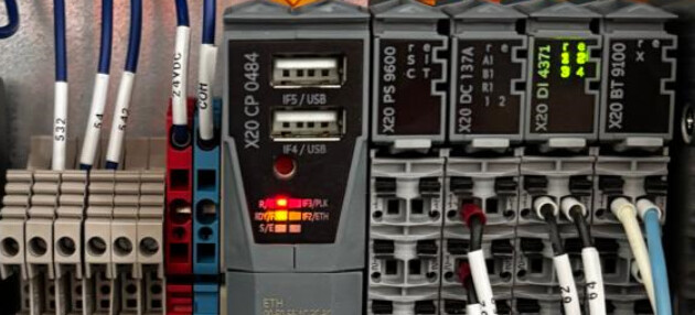

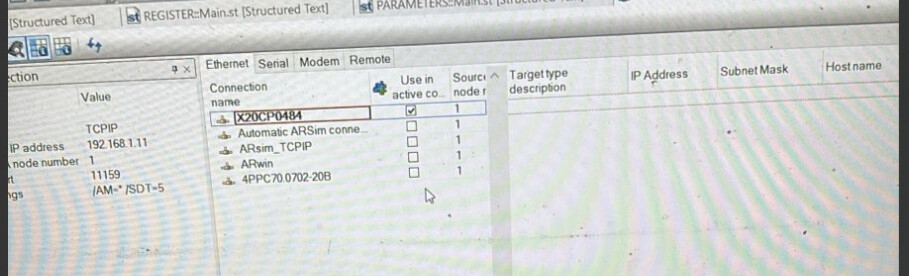

Hello
I am new to B&R, working on my 4th proyect, set of 4 exact same machine, code tested and downloades to first two machine, but the next two
automation can`t find the cpu, cpu is in boot mode, please I need some help.
 ![image](https://europe1.discourse-cdn.com/brcommunity/original/2X/6/682f0d2c277d8a4d20bc90163d5447725a052502.jpeg)
Apreciate your comments, Thank you

The PLC should show up in the Online → Settings, Browse window in boot mode. It would have an IP address of 0.0.0.0 and you’d be able to connect to it. If that isn’t happening, I’m worried that there may be a hardware problem.
What is the sequence of the LEDs that you see?
**Author:** ![SGM](https://avatars.discourse-cdn.com/v4/letter/s/FF8800/32.png) [@SGM](https://community.br-automation.com/u/SGM)\
**Post date:** [October 22, 2025, 5:45pm UTC](https://community.br-automation.com/t/x20cp048-download-code-problem/8750/7 "2025-10-22T17:45:45Z")
online Settings, does not show any thing,
R/E On Red Steady
RDY/ On yellos steady
the rest of it are off
 ![image](https://europe1.discourse-cdn.com/brcommunity/original/2X/b/b5496c93d8c5515301d2a980c12480eaa328c81a.jpeg)
**Author:** ![marcusbnr](https://dub1.discourse-cdn.com/brcommunity/user_avatar/community.br-automation.com/marcusbnr/32/256_2.png) [@marcusbnr](https://community.br-automation.com/u/marcusbnr)\
**Post date:** [October 23, 2025, 2:49pm UTC](https://community.br-automation.com/t/x20cp048-download-code-problem/8750/8 "2025-10-23T14:49:44Z")
A solid Red R/E light and a solid yellow RDY/F light could mean BOOT or SERVICE mode. However, the PLC should show in the AS “Browse” window in either case as long as SNMP has been activated in the Ethernet settings. Because it’s not, I think there might be something else going on. If you are not able to even connect with a blank project that has the correct Ethernet settings, this might be a hardware problem.
What are the LEDs on the rest of your I/O slices doing? In the picture, it looks like only one slice is powered and I find this strange. But that may just be the case at the time the picture was taken. Do you have a steady 24 volts going to your X20PS9600 module?
If you are unable to connect after installing a blank project via USB and your rack is powered correctly, I recommend you reach out to your local B&R support team.

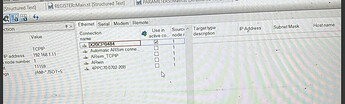

**Author:** ![omer.alumur](https://dub1.discourse-cdn.com/brcommunity/user_avatar/community.br-automation.com/omer.alumur/32/7383_2.png) [@omer.alumur](https://community.br-automation.com/u/omer.alumur)\
**Post date:** [October 31, 2025, 10:27am UTC](https://community.br-automation.com/t/x20cp048-download-code-problem/8750/11 "2025-10-31T10:27:59Z")
Hi Saul,
In the _Physical View_ section of your project, please right-click on the Ethernet interface you are using (ETH1 or ETH2) and check the setting as shown in the screenshot I shared. If it is disabled, please enable it and save the changes. After that, close and reopen the project — this may resolve the issue.
Let me know if it works.
 ![image](https://europe1.discourse-cdn.com/brcommunity/original/2X/9/9f71e812e43903e6642d9a6774522c047a1f16e8.png)
