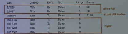

I do see that two devices send a bootup:

  • is the screenshot from the current network or was the recording made in a second network for testing ? I wonder who then sends the NMT and the SYNC if there is only one network.
I set Baudrate 250 kBit. The screenshot is from another network.

The screenshot of the trace is from a different network ? Who did this trace and why don’t you trace your network where this is not working ?
The screenshot is from a different network. I just have to check if the sensor is still working. I don‘t know who did the trace . I don‘t know what you mean by trace your network? I only hava my SPS and the Sensor.
Honestly this is a bit weird. Someone provided this trace to you and you do not know from whom this is ?
With “your network” I am talking about the current setup you have.
