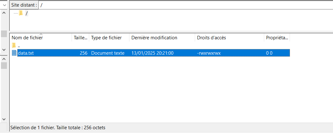

and also when i connected my PLC with my PC i didn’t find the directorie "D:" as you see in the image FileZila, i tried all the possibilities but anything worked.
i don’t know i think i should create the directory or somthing please help me.

It’s normal FTP server root is on D:/ of you PLC. So in filezilla you see / as the root folder of the FTP server not the file system of the PLC.

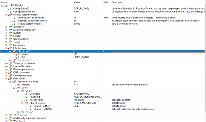

Try set the FileDevice to F: for me the User partition is F: not D:
If you are on AS4.12 your can use USER_PATH instead of a drive letter

The FileCreate function block give you the file identifier. You don’t need to use FileOpen.
As your screenshot show you successfully create the file. Now you can read or write on it and Close it.

finally i created and wrote in the file successfully, that’s why i will shared with you my code like a solution and the config that you should do so as to do this task.

and this is the confi that you should do :
fbOreate : FileOpen;
fbWrite : FileWrite;
fbClose : FileClose;
fbOpen : FileOpen;
hFile : UDINT := 0;
deviceName : STRING[80] :=‘HD’;
fileName : STRING[255] := ‘data.txt’;
writeBuffer : STRING[255] := ‘yacine’;
bytesWritten : DINT := 0;
step : INT := 0;
status : DINT := 0;
fbCreate: FileCreate;
DirCreate_0 : DirCreate;
But you should know that the PV memory of the PLC is limited and those functions didn’t work in cycle.
