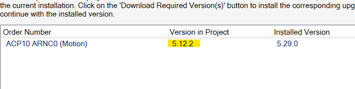

ACP10 ARNC0 5.12.2, where to download?
Cant find required verion anywhere. Where can I download it?

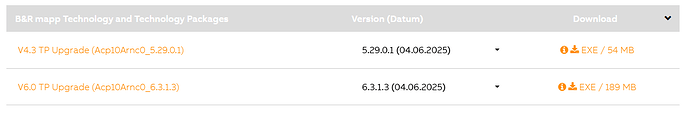

in June/2025 B&R did an “Reevaluation of Dual Use Compliance of ARNC0 & mapp CNC” due to changing export rules.
This lead to the new situation that the whole ARNC0 was moved to DualUse relevant.
You now have to ask your local B&R office to aquire a download link for the ARNC0 upgrades.
There will be new Technology Packages with the same name, but they will not contain an ARNC0 part, only the _EXT Upgrades, which have to be requested, will in future hold the ARNC0 part.
Sorry for this inconvenience. I hope you can get the upgrade fast.
