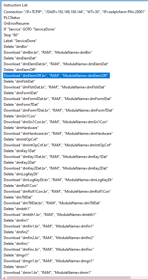

Trying my first conversion to AS6 from an existing AS4 project. We use the library DataObj to create / read / write data modules for saving all our plant engineering parameters directly on the PLC CPU. Within our SCADA we have tools to upload the data modules to the PC HDD so then we can use B&R RUC tool to transfer to another CPU (backup purposes). For this first conversion I have tried transferring the data modules using RUC V6 - but I get error 11150 which I assume is because the data modules were created on AR4 and not compatible with AR6.
Is this correct that the data modules are not compatible?
If not compatible then any chance of a conversion tool so we can save our plant engineering parameters: *.br modules from AR4 format to AR6 format? Could this be detected in the RUC V6 tool and automatically converted? It would be a huge task for each site to manually enter all the current values as well as mistake prone.
Example RUC created:
there is no converter I would know of. If you have the original dataobject you could simply copy&paste the contents of a AS4.x dataobject into a new created dataobject with AS6.x but there is a second issue.
Single download of BR modules is no longer possible and you will get an error - this includes dataobjects.
Please see online help for this:
B&R Online Help
Basically “download” is no longer available and was replaced by project installation but this also results in no longer being able to download a single BR module

Just to be clear we do not create the data objects in AS. We actually call DatObjCreate in the PLC program to create the data objects at run time - so the data object never exists in AS, only on the PLC CPU. This allows us to not worry about managing data objects - the PLC creates the data objects as required.
I have tested the individual *.br module downloads of data object using Runtime Utility Center V6 and it works fine which is great for how we manage our data objects.
