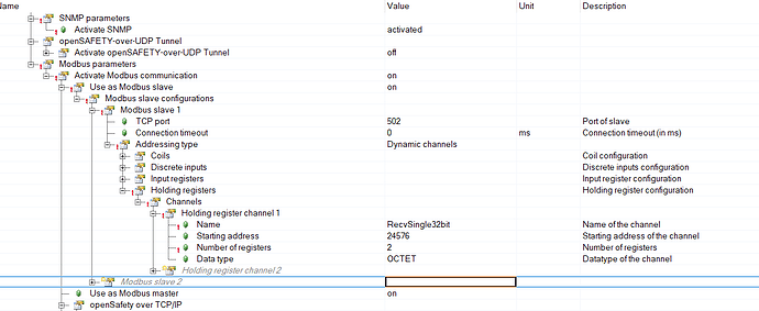

I’ll also attach my current Modbus TCP Any configuration, as well as the PLC-side mapping of FLOAT and DINT values.

If the controller is acting as a ModbusTCP slave and therefore as a TCP server (“waiting for queries, just having the data”), the ModbusTCP_any device isn’t needed.
In a nutshell:
As I understood your gateway use-case (“transforming” a serial slave to a tcp-based slave), I think you want to act as a ModbusTCP slave, therefore the ModbusTCP_any device isn’t needed / suitable.
You have to use the “controller-as-ModbusTCP-slave” setup described in the following help link

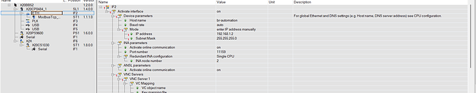

Dear [ [Alexander Hefner],
Thank you for your valuable time and the insightful guidance you provided earlier.
Following your recommendation, I was able to successfully verify Modbus TCP Slave communication using the ETH Modbus Slave configuration with Modbus Poll. Your proposed solution worked excellently, and I agree that a proper gateway should transmit 16-bit data as-is between Modbus RTU and TCP.

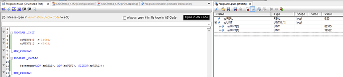

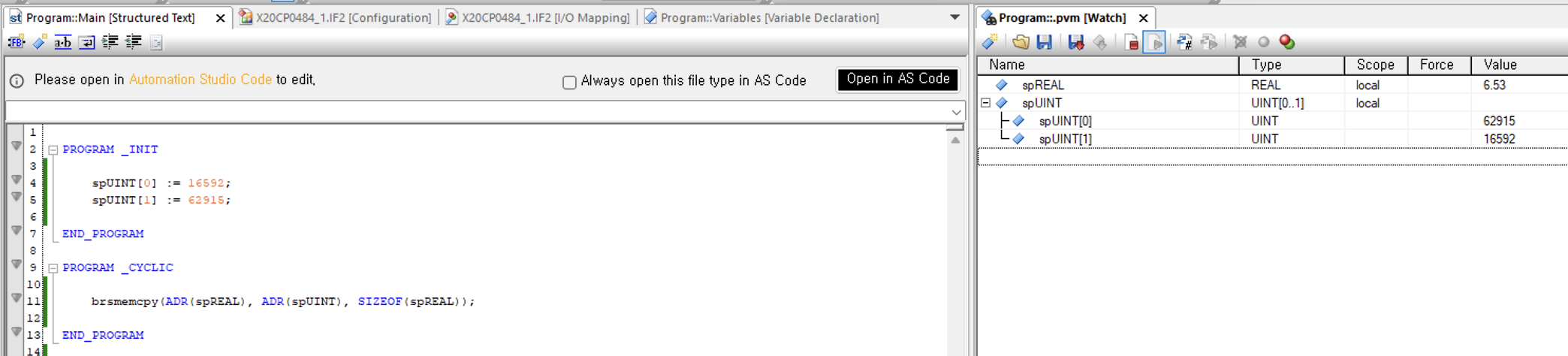

The ModbusTCP_any intended for MODBUS TCP slave. So, It cannot use for MODBUS TCP master.
You can convert UINT MODBUS value to REAL(float32) value.
For example,
  • 2 of UINT value below,
    • spUINT[0] = 62915, spUINT[1] = 16592
  • Converting value to REAL using AsBrStr library
    • brsmemcpy(ADR(spREAL), ADR(spUINT), SIZEOF(spREAL);
  • Then you can get value 6.53
Or, you can use OCTET alternatively.

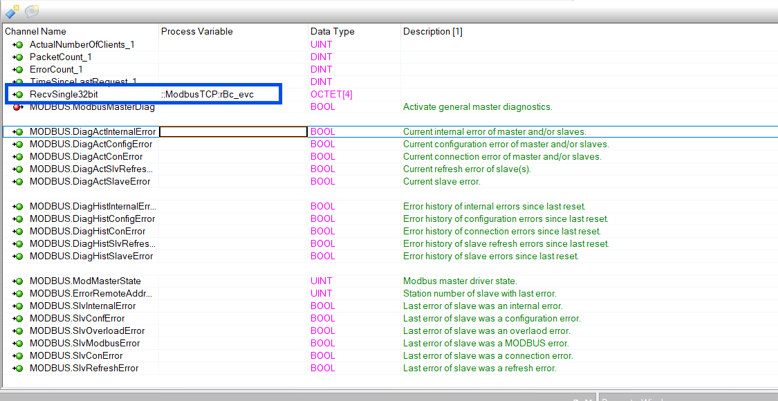

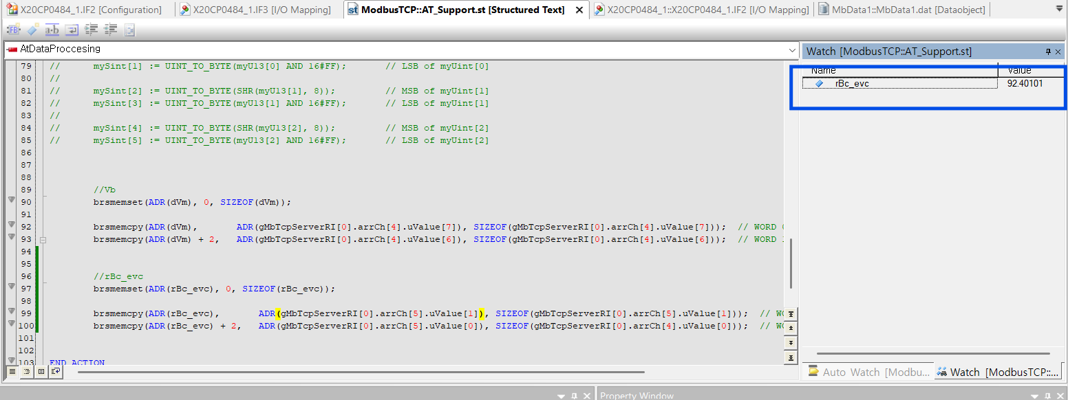

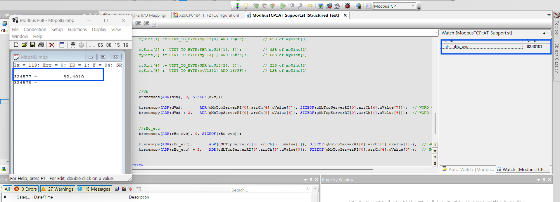

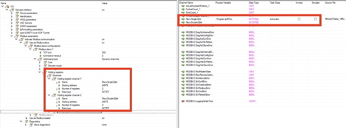

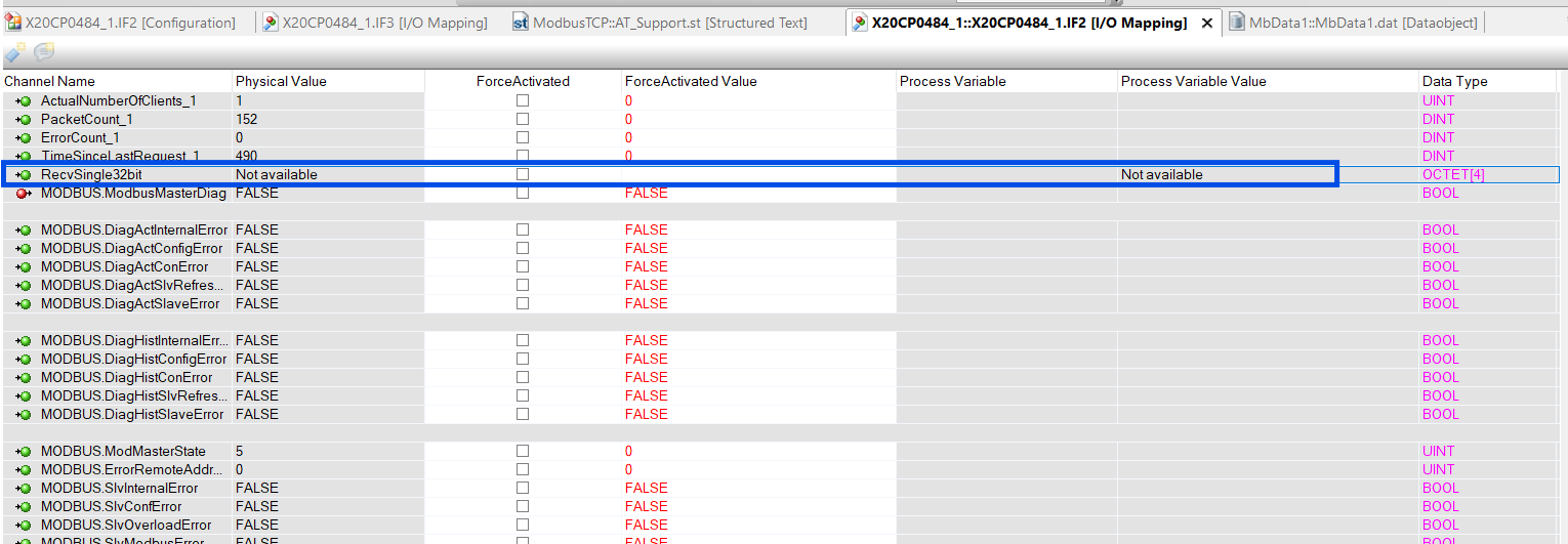

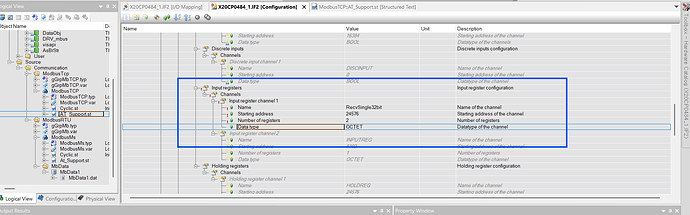

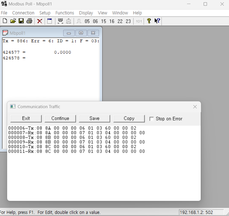

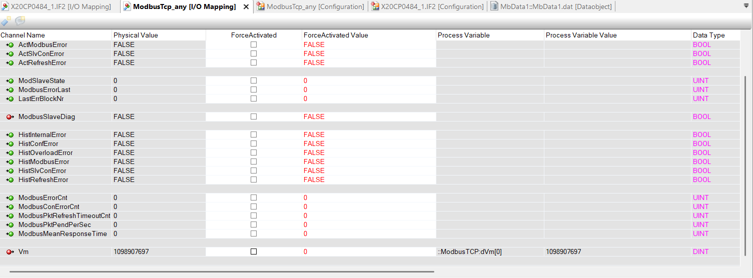

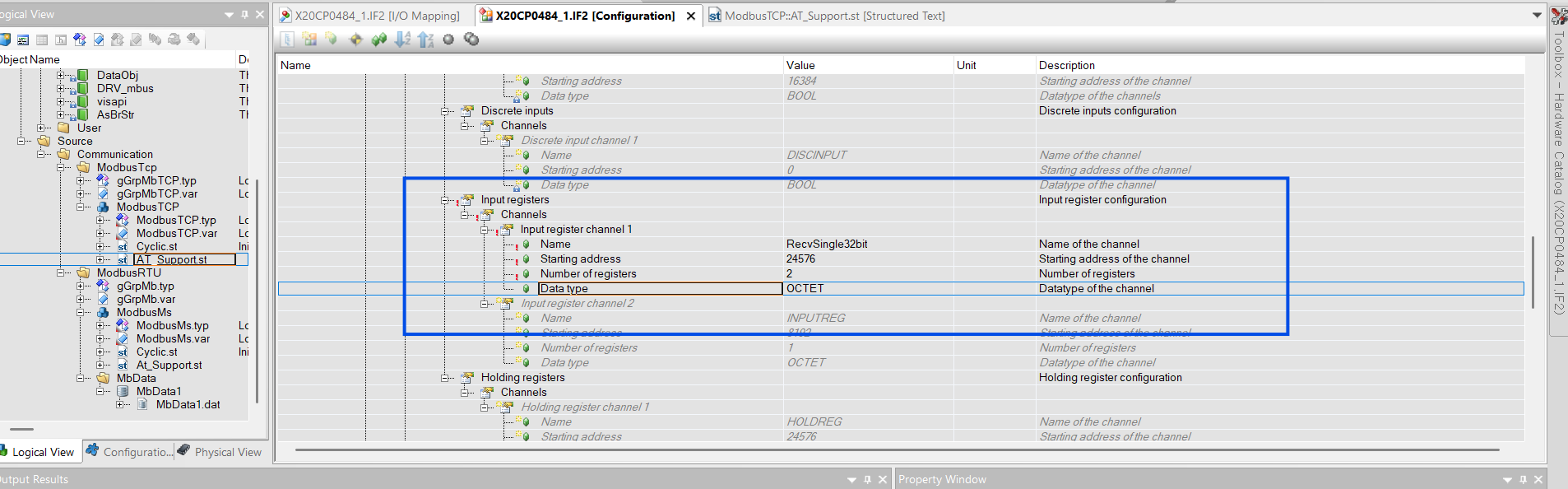

Thanks to the guidance I received here, I was able to successfully set up Modbus TCP communication between my PLC and Modbus Poll. I used Octet-based mapping to assign a REAL type variable, and the project compiles and downloads successfully.
The project compiles and runs without any errors, and the Modbus TCP communication appears to be working correctly — Modbus Poll receives responses from the PLC.

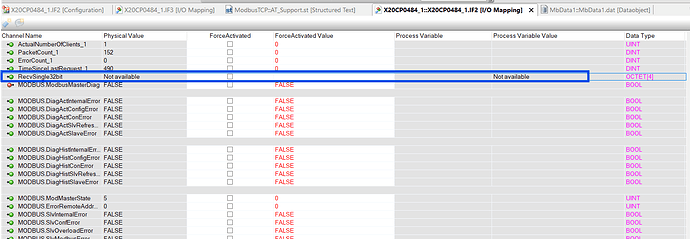

[Modbus TCP Communication Established, but “Not Available” Error When Reading REAL Value]

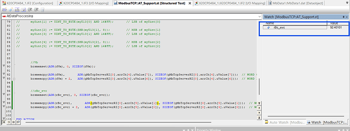

Unfortunatly, the OCTET type cannot monitoring in I/O mapping page.
You can monitoring value in code editor(monitoring mode) or watch window.
Best Regards
“Hello, I had forgotten that I needed to use Input Registers to output values. Thanks to your help, I was able to solve the problem. I really appreciate your support.”
