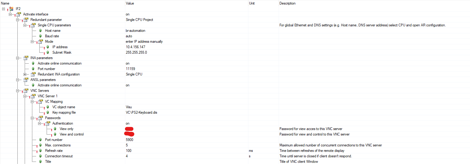

You can define a VNC object in the Ethernet configuration of the CPU as a VNC server and then set several HMIs to the IP address of the CPU with the same port (default is 5900), e.g. 10.10.125.10:5900
This makes the CPU the VNC server and several HMIs can access this server
You can also set several VNC objects in the Ethernet configuration and change the port.
e.g.:
HMI-1 = 10.10.125.10:5900 = VNC object 1
HMI-2 = 10.10.125.10:5901 = VNC object 2
HMI-3 = 10.10.125.10:5902 = VNC object 3

You can have a single VC4 visu and deploy it multiple times but then all of them would point to the same variable which is most likely not what you want. For this type of visu you should use mappView. It would work perfect for that scenario.
