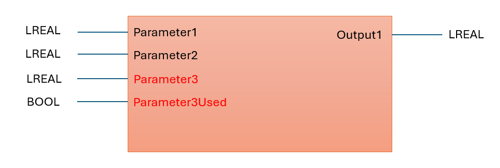

i may just add some ideas about how to work around this:
You can Add an Second Input Parameter Named like “OptionxxxUsed” to pass the Information to the Function if a parameter is used or not. With this information you can Initialise the ParameterValue internaly to a Default value.
It adds a little bit of complexity to the Function Interface but you then have the possibility to have optional Parameters.
Using a Functionblock interface Definition like descriped by Michael adds some more comfort.
IF Parameter3Used = 0 THEN
  InternalParameter3 := DefaultValue;
ELSE
  InternalParameter3 := Parameter3;
END_IF
