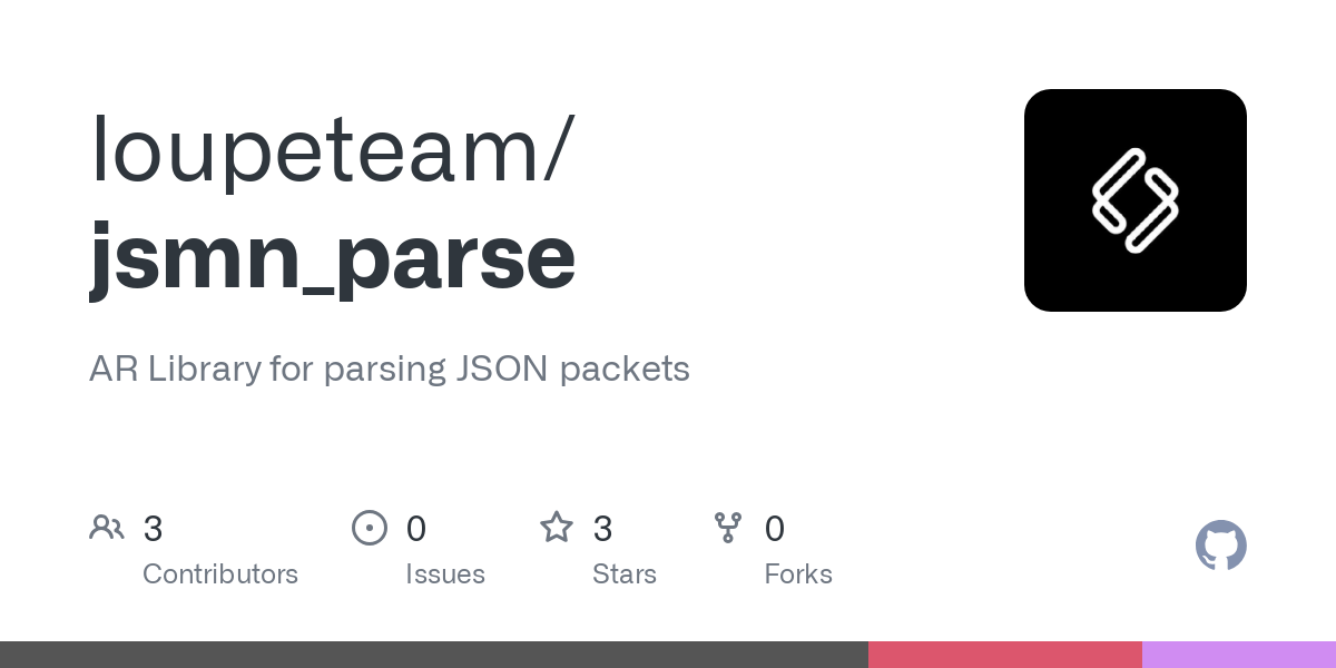

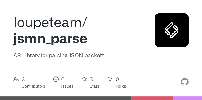

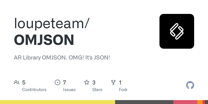

The’re also some implementations / functions on Github regarding JSON (some with source code others as binary module only), maybe one of them is useful for you:
