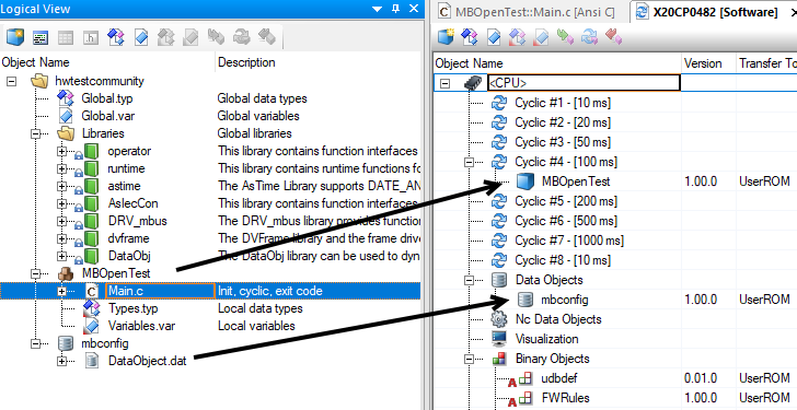

since I haven’t AS4.7 available anymore, I can’t do any testing: so the following information and screenshots refer to AS4.12 → I cant swear that everything looks similar, sorry.
Also please note, that all the screenshots of hardware and versions are examples only, and will differ from what you have in your project.
Also, I can’t say if the two topics below are the cause for the behavior or if there’s even more behind in the code a.s.o., but I’m definitely sure about that you have to check and change at least those topics.
  • If using a X20CS… communication module, the device string cannot be “IF1” only - the device string has to be the complete interface path. As a example: if a module is plugged onto X2X bus, the interface path is at least something like < X2X Interface >.< X2X Slot >.< Module interface name >
    For example: let’s assume the X2X interface is IF6, the CS module is the third on the bus, and the interface on the CS module is IF1, then the device string is “IF6.ST3.IF1” (see sample screenshot below).
  • If using a X20CS… module together with serial frame driver (the MBxxxxx() functions are using that driver called “DvFrame”), the module has to be configured to the function model “stream” or “cyclic stream” (has do be done in Automation Studio, configuration of the module).
Sample screenshot of AS hardware configuration to see how the interface string is built (as described above), and to see the setting of the function model in the CS modules configuration:

getting status 20245 means, that a process variable, that is used inside the data module, does not exist in the PLC.
You have to mention, that if you declare a process variable (by _LOCAL or _GLOBAL or inside *.var file), but don’t use it anywhere in the code, then for performance reasons this variable is not installed into the PLC (because it’s nowhere referenced).
So you have to:
  • declare the variable
  • call it somewhere in the code (normally in the _INIT) - this call is really only to convince the compiler that he has to “build and install a process variable object into the PLC”
  • depending on if it’s a local or a global variable, address it in the right naming way inside the data module.
For example let’s assume, your task where MBMopen() is called has the name “MBOpenTest”. Inside “MBOpenTest”, there’s a _LOCAL process variable called “myMbDummyVar” declared.
To use this variable for the data module, you have to
  • add a “dummy call” somewhere in the code
  • in case of a _LOCAL declaration, use the right syntax “Taskname:Variablename” inside the data object.
I don’t have suitable hardware to really run some code, but it should look somehow like this:
