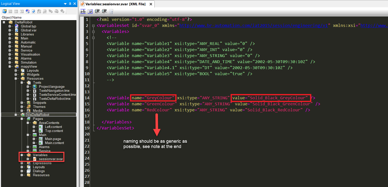

Then you need to create your UserDefined style, go to: Toolbox → Style and add it under StylesSet. Into this style you can add all of user defined style changes, so they are in one place. After that you need to name its ID and add this ID to the StylesSet of the theme. In the file named UserDefined.styles you need to add the styles of the indicators. Then, name the IDs of each style, this will be used for the value of a session variable later.
Now you need to create the session variables that will be used to change the style property of the elipse widgets. Click on the folder variables in the mappView folder and add session variables file, go to: Toolbox → SessionVariable. The value of the session variable must be the corrsesponding ID of the user defined style of the elipse widget.

NOTE: It is not recommended to name the style same as the colour you are using in that style.
Imagine you name the style RedColour for warnings, but then you change the warning colour to yellow and red colour will be set for emergencies…
Your style naming should be as general as possible. Such as: SwitchedOn/Off, Engaged, Paused, Error, Halt etc.
