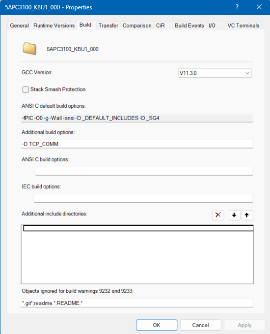

There is a way to ignore these warnings for objects you specify in the Configuration properties:
New build option: “Ignore objects for warnings 9232 and 9233”
Ok, so I just have to specify filenames or file types to be ignored? I tried to add this:
.git,.git*,readme.*,README.*
But it didn’t work. Do I need to specify the path of each files?
You should use ; as the separator instead of ,
Ok, using ;works. Thanks!
I’ve added this:
*.git*;readme.*;README.*
and now I don’t get these warnings any longer.

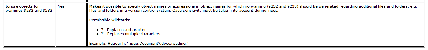

But in the B&R Help is wrong there is an example that is clearly wrong as it uses , as separator instead of ; :
Header.h,*.jpeg,Document?.docx,readme.*
