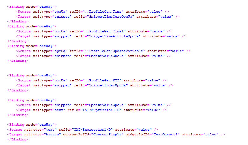

I think I have a possible solution for you.
Create two snippets. One for the updating of the value and one for the indexText.
Create your IndexTexts and additionally a TextKey without the index.
Use the snippet for updating the Value as before.
Use the snippet for the IndexText as your value of the TextKey.
Create your bindings as following.
If the update value snippet is used as your current TextKey the value gets updatet.
If the update value snippet is not used the binding is not being applied, but is still active without effect. No entries in the logger.
With this setup I was able to accomplish the usecase.

I tried the solution given by you and as also Harshal said the values in the text were static and not updating. However i found one solution, as i came to know that if we keep updating the value it works. Thus i created an update variable in the snippets and its a kind of counter which continously increments. Then i am able to realise the solution with proper update.
Note: Please ignore the variable names - I used the MV highlights project and my already available vars.
Please try out this.
