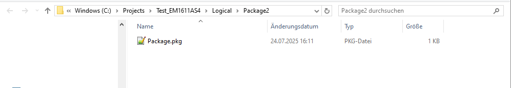

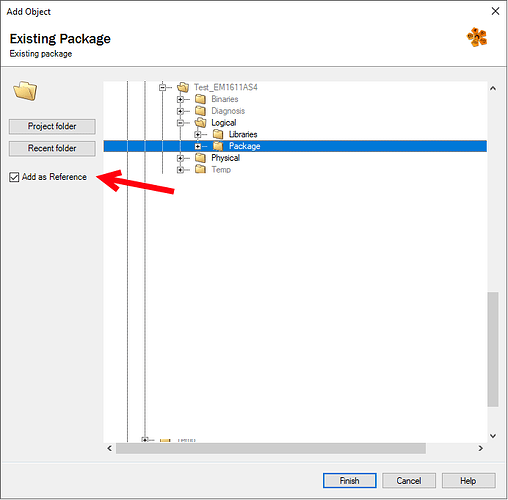

please try this. The small Checkbox “Add as Reference” must be marked. Its only active if a valid folder was selected.
In Properties you can see the Source of the Reference.
We can see that in the project there is no copy in the Packages, only the Reference entry in the .pkg File.
Thanks, selecting the checkbox “Reference” works.
