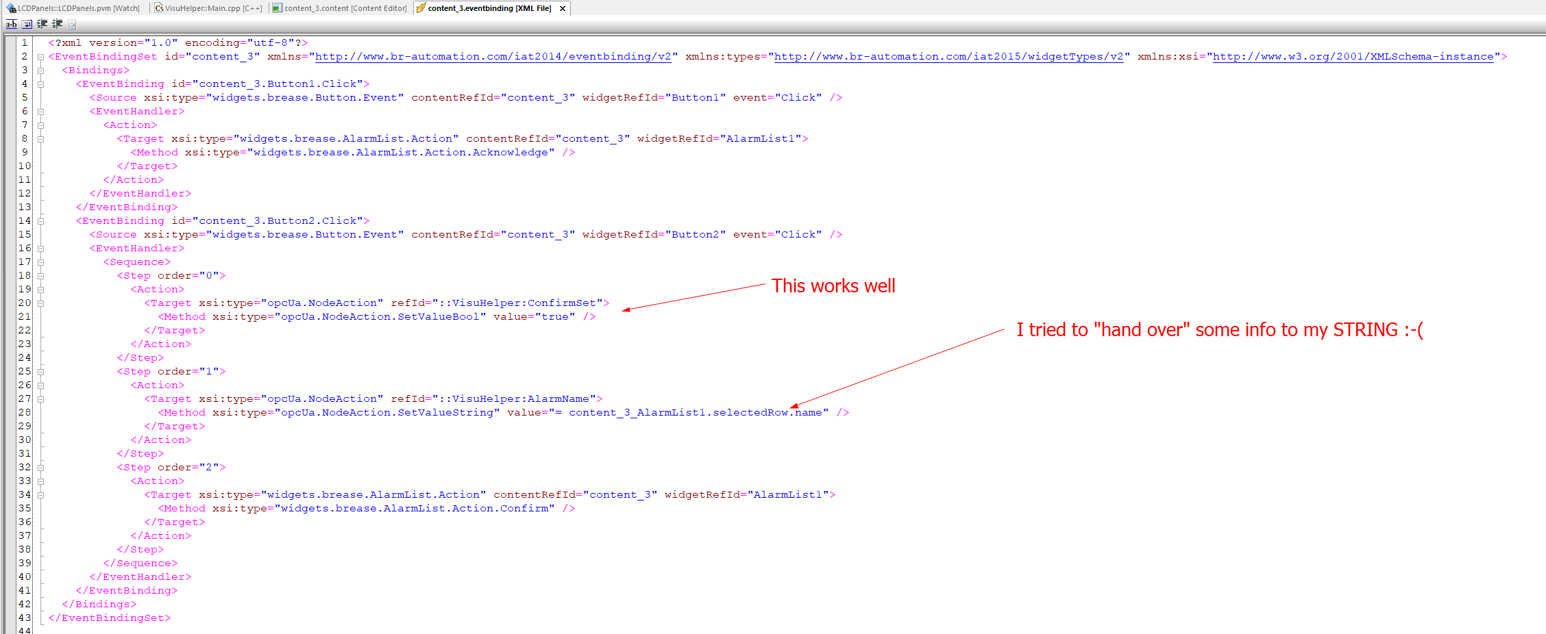

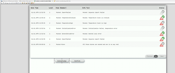

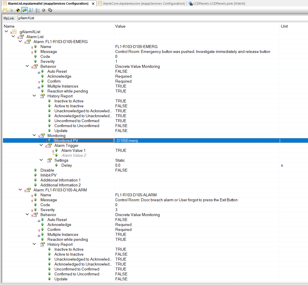

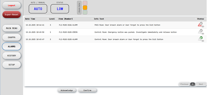

I work with AS V6.3.3.14 and implemented a simple Alarm system - all Alarms are Bools created in my C++ tasks. Ideally those BOOLs should be set to 0 by the User who will click the “Acknowledge” or “Confirm” Button . As I have approx 200 Alarms.
Anybody knows if there is an easy way to achieve this? Some screen shots:

But this only acknowledges the alarms, setting the bool values that triggers the alarm to zero is part of the application (and has to be, because a alarm system cannot decide if a alarm really has gone).
I am not sure I fully understand the use case, but if you want the button on the mapp View HMI to also set PVs, you will have to enable these in OPC-UA. Then you can use Sequential or Parallel actions to trigger both a widget and an OPC-UA action. Purely from MpAlarmX it is not possible to control PV values.
However, I don’t think there’s a way to know which alarm has been acknowledged/confirmed (if that matters)… There may also be issues with the two representations going out-of-sync…

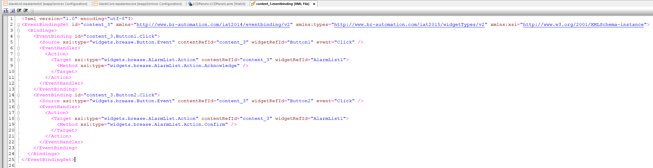

I actually tried below (but its not working):
Anyway: I probably give up on this and just let the User clear all the process Errors (and Warnings) at once by pushing an extra button (Super-Reset).
