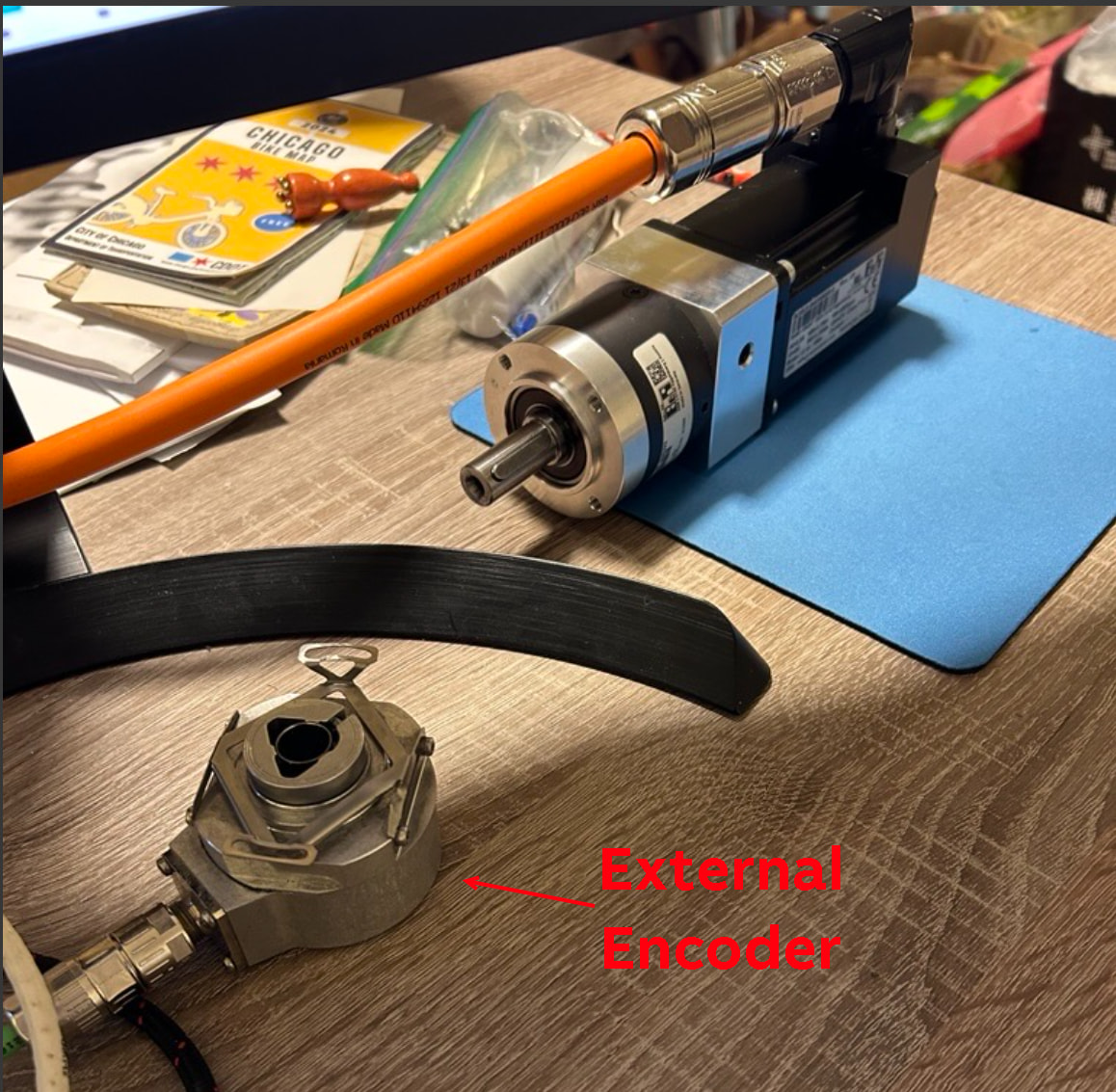

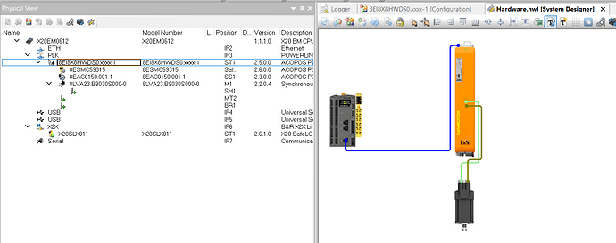

I have my hw with few components:
Below my configuration for 2-encoder control:
The external encoder is not connected to anything:

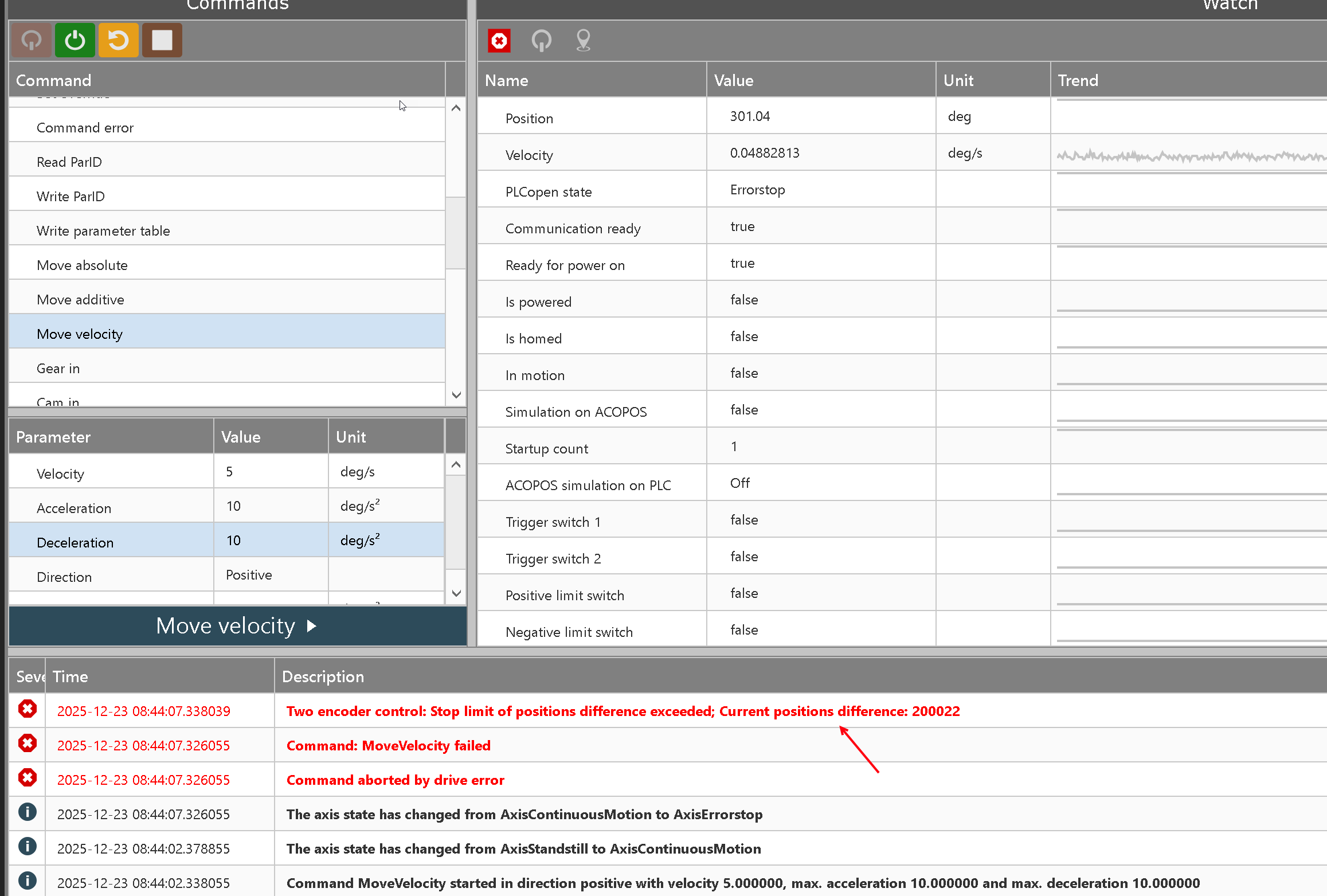

I homed my axis in both sides, gray (home direct) and yellow (home direct).
I applied a move velocity and I see the correct error on gray side:
but I don’t know why on the parID 309 I see a movement of the external encoder:

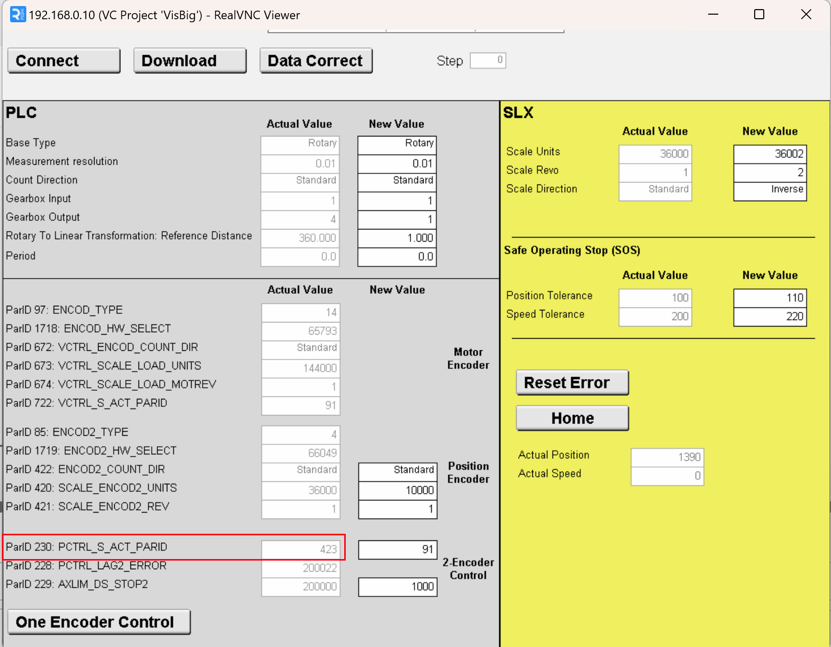

It seems even if I have configured on gray side the 2 encoder control, on safety side the encoder for position control is the encoder mounted on the motor and not my external encoder.
On the gray side I read all ParIDs for 2-encoder control and they look correct:
In particular you see ParID 230 PCTRL_S_ACT_PARID = 423, 423 is
At the end I see the 2-encoder control is working fine on gray side, but not on Safety side.
Any idea where my settings is wrong?

The only solution to have the external encoder read in by the safety system is to swap the encoder interface on the drive. ( The AC150 is not usable on the safety part )
Change it to:
  • motor encoder to the AC150 card.
  • External encoder on the internal interface.
