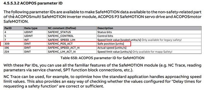

I’m doing a test with SafeMotion, but I don’t see the correct value of the ParID 309: SAFEMC_POS_ACT.
We have few ParIDs on the Gray side to monitor few SafeMOTION data:

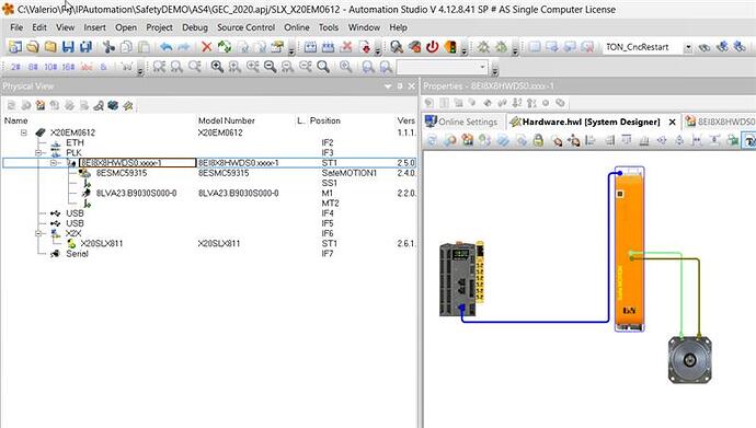

I have very simple configuration:

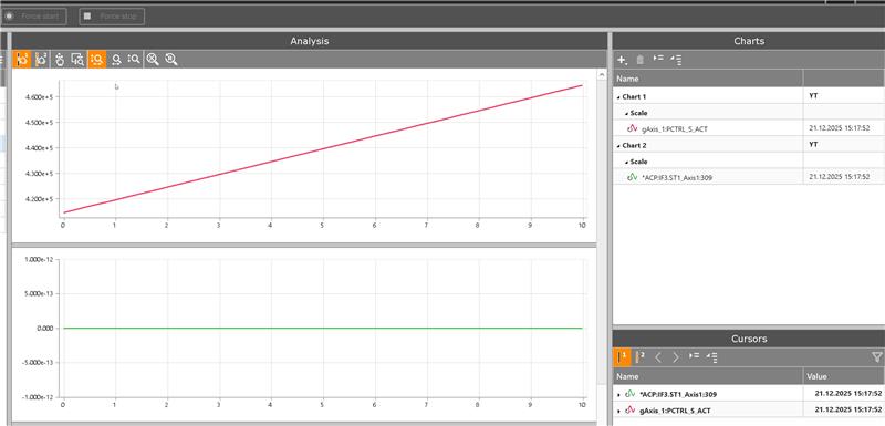

As you see below the value of that ParID is 0 even when the motor is spinning:

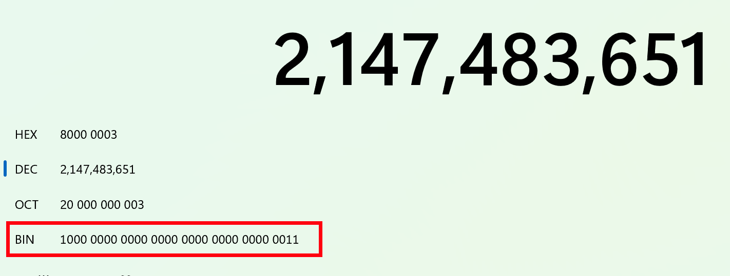

Did you home the safemotion part ? Is the Safe position bit valid ? You could read the status with ParId 4 .
Absolute position function set:
Bit24: StatusNotErrorEnc     ..  Encoder error is not active
Bit25: StatusHoming          ..  Safe position is valid

I added the ParID in my trace:
I homed my axis on “gray“ side with home direct:
so should I home the axis inside the safety application?
Thanks Job,
I see now the correct value on my ParID 309:
after I added the FUB SF_oS_MOTION_AbsPos_BR:
